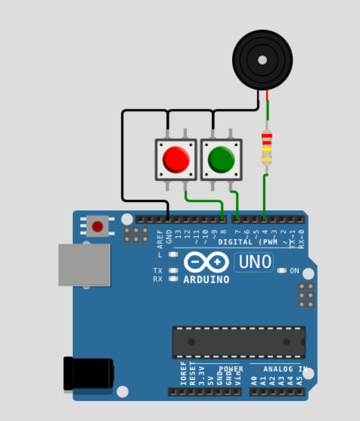

So I want my "button 8" to stop the alarm or the buzzer or reset the arduino so the alarm stops.
My coding skills are bad so I don't know what to do here, because other codes have some songs or much longer non-understandable code, I would be happy for my project to finally work.
  pinMode(4, OUTPUT); // Speaker pin
  pinMode(7, INPUT_PULLUP); // Button connected to pin 7
  pinMode(8, INPUT_PULLUP); // Button connected to pin 8
  static boolean alarmPlaying = false;
  if (digitalRead(7) == LOW && !alarmPlaying) {
    alarmPlaying = true;
    while (digitalRead(8) == HIGH) {
      tone(4, 3150);
      noTone(4);

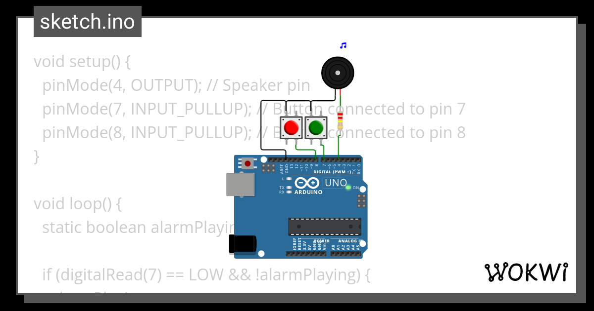

your code kinda works if you hold de stop button for more than one second because your while loop
only evaluates the state of the button every second due to the presence of delay() inside the while loop
test your code here:
if you want immediate reaction, you need a small state machine for example and using millis
For extra information and examples look at
(instead of flashing the leds you would turn the sound on or off)
if you can't make it and want a ready made solution
try this
nonBlockingSoundPlayStop - Wokwi ESP32, STM32, Arduino Simulator
the code:
const byte playPin = 7;
const byte stopPin = 8;
const byte buzzerPin = 4;
enum state {SILENT, BEEPING_ON, BEEPING_OFF} state = SILENT;
unsigned long chrono;
const unsigned long soundOnDuration = 500; // ms
const unsigned long soundOffDuration = 500; // ms
  pinMode(buzzerPin, OUTPUT);
  pinMode(playPin, INPUT_PULLUP);
  pinMode(stopPin, INPUT_PULLUP);
  switch (state) {
    case SILENT:
      // we are silent, if we press the play button, then start playing the sound
      if (digitalRead(playPin) == LOW) {
        tone(buzzerPin, 3150);  // start the sound
        chrono = millis();      // note the start time
        state = BEEPING_ON;
    case BEEPING_ON:
      // the beeping is on, check if we need to stop
      if (digitalRead(stopPin) == LOW) {
        noTone(buzzerPin);
        state = SILENT;
      } else // check if ON duration has elapsed
        if (millis() - chrono >= soundOnDuration) {
          noTone(buzzerPin);
          state = BEEPING_OFF;
    case BEEPING_OFF:
      // the beeping is off check if we need to stop
        noTone(buzzerPin);
        state = SILENT;
      } else // check if OFF duration has elapsed
        if (millis() - chrono >= soundOffDuration) {
          tone(buzzerPin, 3150);  // start the sound again
          state = BEEPING_ON;
