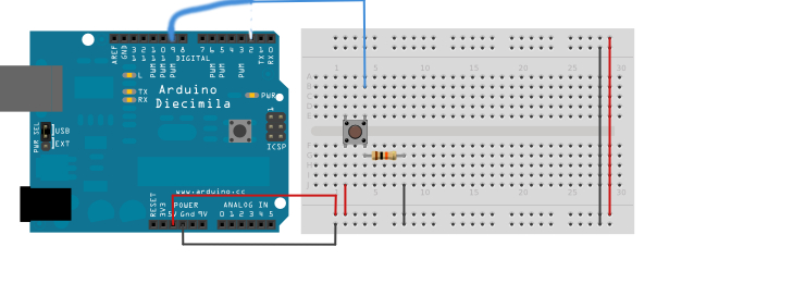

Hi all,
I am adding a feature to my program that when you press a button and hold it goes to the "Countdown" section in the program and then into the "LastChance" section where it beeps faster and if you let go at any time it goes back to section called "Check".
The problem is that as soon as the unit gets switched on it starts beeping continually.
It appears it might be in this section:
 if (buttonState == HIGH) {
 goto Countdown;
If I change "HIGH" to "LOW" it never starts beeping no matter if the button is pressed or not pressed.

.....It is wired the same as this https://www.arduino.cc/en/tutorial/button except the button is wired to D9 and the Beeper to D8.
There's is almost never any reason to use goto in C++ programs so I'm guessing that your program being scattered with them is what's causing the problem. But they're so confusing I'm not even going to try to trace the paths.
Perhaps it is time to learn how to write functions and incorporate them into your program.

The sections that detect if the button is pressed or not pressed like:
 goto Countdown;
or:
  if (buttonState == LOW) {
  goto Check;
The problem seems to be that it is detecting that the button is always pressed on.
This might indicate a wiring problem but it is not as I uploaded this program and it worked great.

Does anyone have any idea of what the problem is?

Here is a diagram of the wiring of my button (attached).
Thanks
Zeb

Did you check if the button was wired correctly?
Steve
Hi Steve,
Thanks for the link!
I have checked the wiring of the button and it appears to be right.

What's the difference between a pull-up and a pull-down resistor?
I am using a standard 10K resistor.
Thanks
Zeb
Hi Delta_G,
I appear to have a pull-down resistor because the resistor is connected to ground.
Thanks,
Zeb
