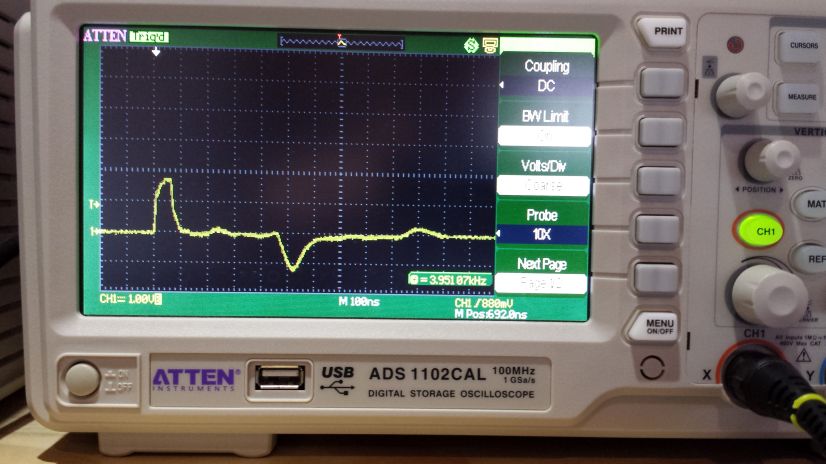

I got sufficiently interested in this that I decided to to try it out. I connected digital pin 2 through a 150 ohm series resistor to one of the wires in a reel of 2-pair telephone cable, with the other wire in the pair grounded. The reel was originally 100m but I had used some, so I think there were 60m to 80m remaining. I used this code to generate a 62.5ns pulse on pin 2:
pinMode(2, OUTPUT);
byte on = (1 << 2);
byte off = 0;
PORTD = on;
//delayMicroseconds(10);
PORTD = off;
delayMicroseconds(500);
Then I un-commented the first delayMicroseconds call to try using a step function instead of a pulse. The attached images show the scope trace I saw at the cable/resistor junction. The first is using a pulse, with the far end of the cable open circuit. The second is with the far end of the cable short circuit. the third and fourth are using a step, with the far end of the cable open and then short circuit. Horizontal scale is 100ns/division, vertical is 1V/division.
Next step is to see if the analog comparator is fast enough to take measurements.

I've found that I can use the analog comparator and timer 1 input capture to detect the reflected pulse, although the timing I measure depends very much on the voltage I apply to the other comparator input. I think the propagation delay varies substantially with the amount of overdrive (I'm seeing well under 500ns in some cases). In any case, with a quoted typical propagation delay of 500ns, a faster external comparator is evidently needed for this application. I'll add a TLV3501 to my next component order.
