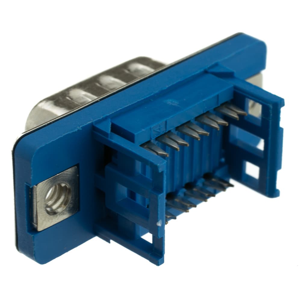

Those wires are meant for IDC ribbon connectors, the whole cable gets inserted and crimped inside a connector with "x" spades/knives that cut through the insulation, into the conductor.
Not a good photo, but you can see how the knives are alternating top row, bottom row, top row, bottom row... so at the other end, you need to get the opposite pattern to make it a straight-through, or learn to macrame. : )

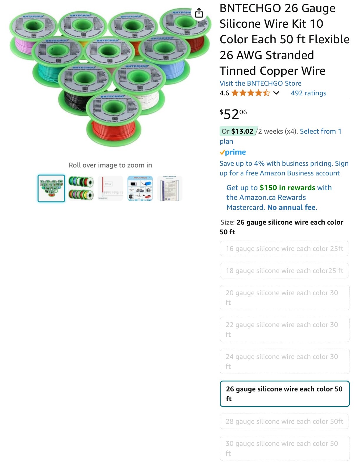

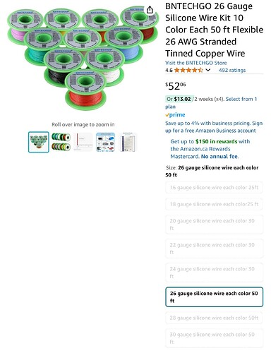

  • I converted to silicon insulated wire years ago, as below.
  • The strand count is phenomenal and they work well with Dupont connectors.
  • Suggest you use 24 or 26 AWG wire, 26 should be double at the stripped end.
  • 26 has 30 strands, 24 has 40, 22 has 60 and 20 has 100 strands !
