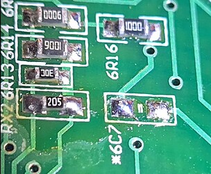

As you can see: the ground connector of the black multimeter probably has a larger resistance than the shunt resistor...
Not good engineering...
I am also interested what the turning knob contacts (other side of the print) look like. But better not have a look at that, because taking that apart might ruin the alignment of the lcd contacts ...
Should be gold plated...
What happened to 6c7 in the red one?

That is mean that chip is missing? Maybe a factory? Or dropped out itself. Or maybe is not relevant. (It is from Kaufland).
I can solder it to make a bridge if you like?

Do not bridge the gap!
C stands for capacitor!
Often boards are used for more than one version of some products. So a more luxury may have a cap there (for the continuity buzzer or whatever).
But this one seems to be messed with...
And caps usually don't fail...

On 6C7 is gap too, but it is untouched. Chips order are slightly different, not in same place compared with mine.
