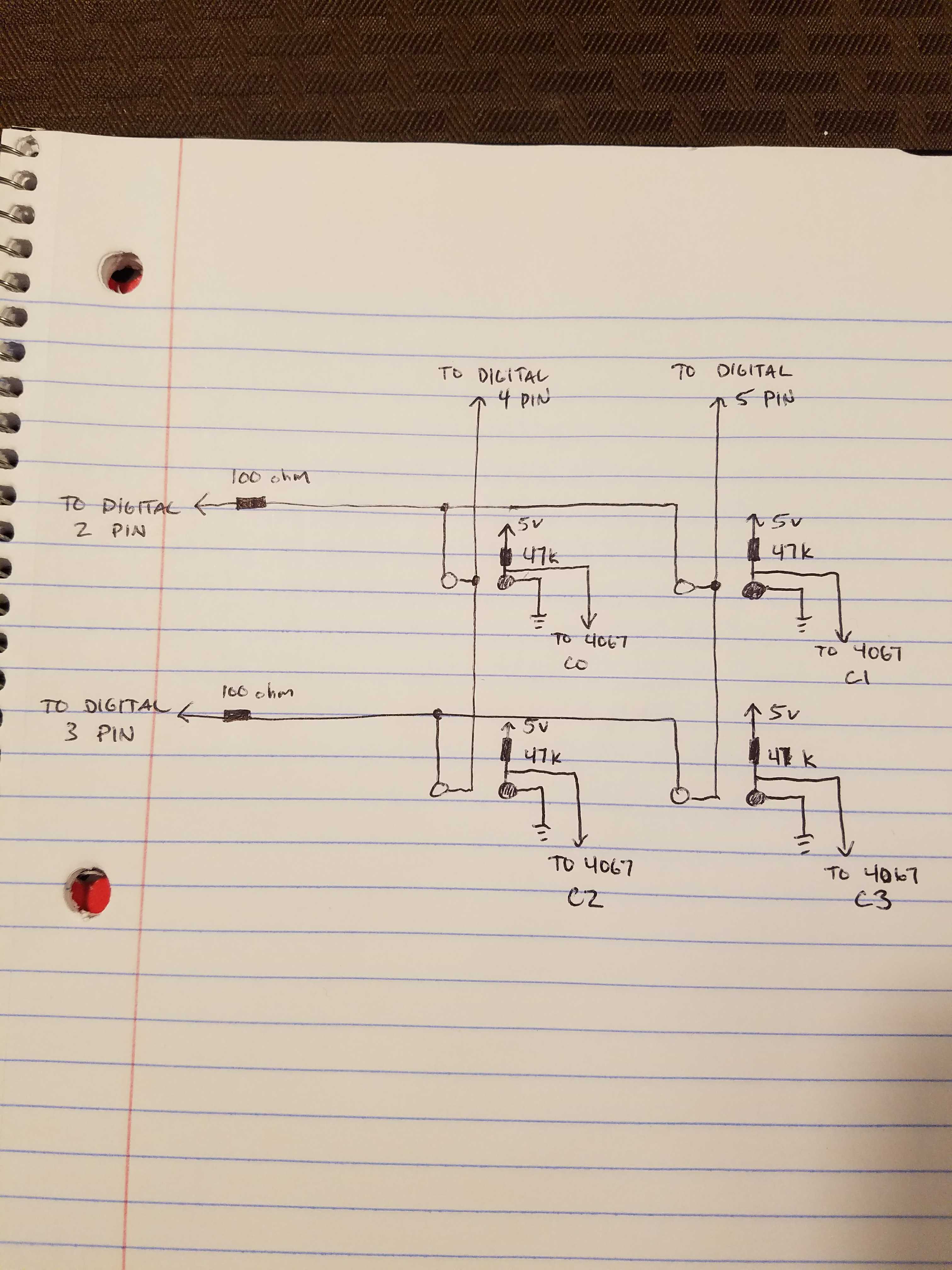

Here is my schematic. I already have made one of these sensors. Oh and sorry again Paul, no need to be rude. I just am not familiar with the forum yet. Thanks.

What is your sensor supposed to do, and why do you want to calibrate it?
It is an IR proximity sensor. I am attempting to make a table to control LEDS when something is in proximity of the IR sensor. The calibration cancels out ambient light so there is no interfearence, I was trying to figure out how to calibrate multiple sensors.
This is the code I have used to get the single proximity sensor to work for me. I am still learning basic functions for the arduino. Would I have to write multiple functions to control multiple sensors?
No. Write one function and call it with sensor-specific parameters.

The idea being proposed was that the value passed to the function was the pin number to read from, not the number of times to read the sensor connected to the pin. It was assumed that you read the pin the same number of times, regardless of which pin it was.
Understanding and applying arrays will make this a piece of cake.

Here is my schematic for my IR leds and Photodiodes. I hooked up a 4067 and I am trying to read the sensor values which seems to be working, but my IR led array is flickering. When I remove the code for the 4067 the array seems to work just fine.
Here is my code....I found it here thanks to Paul :slight_smile: .....
