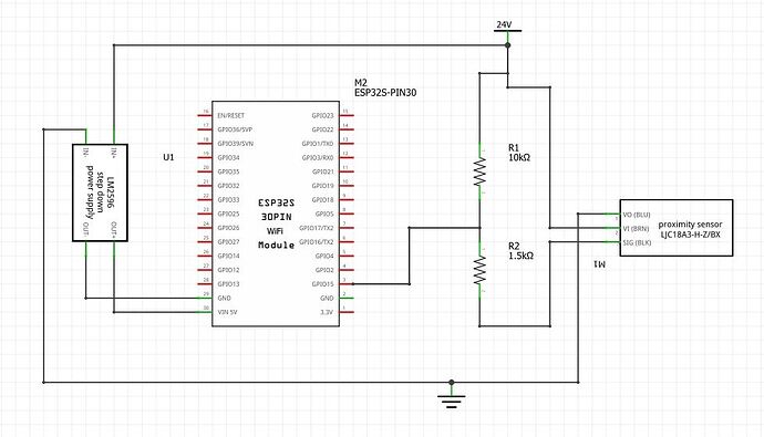

for the power source has been separated between the microcontroller and inductive proximity sensors, for the sensor using 24V.
Three-wire sensor with open-collector/open-drain output?
Connect GND to GND, output to ESP32 pin and set mode to INPUT_PULLUP.
What is "fhe sensor"?
sorry I missed the description of the info about the sensor used is “Inductive Proximity Sensor NPN NO 8mm LJ18A3-8-Z/BX”

I'm still a novice in cable design. for the components esp32, buck converter, 24V PSU and Inductive Proximity Sensor NPN-NO , from this picture is it correct from the cable ?
Not enough information. Please post a link to the product page for the exact switch you have.
For example, if it is this one, the sensor runs on 5V, which would make MUCH more sense for a 5V or 3.3V Arduino.

The sensor output appears to be open collector, so you need to connect only sensor GND and output to the Arduino, using pinMode(pin_number, INPUT_PULLUP);
Proximity is indicated by LOW on the Arduino input pin.

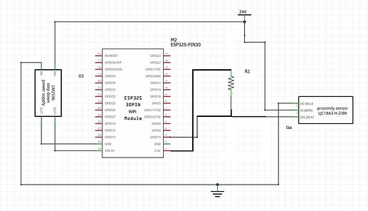

Remove 1.5 k resistor and connect 10 k resistor to vcc (3V3).
Is this different to the one I made before and can you explain how it works?
I'm still confused about what it is, when to use it and how it works. Anyway, thank you very much for the support of everyone who has given advice
Yes. Can't you tell from the schematic diagram?
An NPN open collector output is designed as an interface between two different logic level voltages. To use it, a pullup resistor is required from the sensor output to Arduino Vcc. That can be internal resistor (turned on with INPUT_PULLUP) or an external resistor to Arduino Vcc.
With a long sensor cable, you might want to use an external 1K resistor, to increase immunity to electrical interference.
