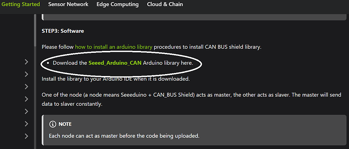

Look up the example code for CAN-BUS Shield library, it looks like it is for the seeed shield.
The seeed site even gives you the link to the library.
Hi, im using this Library.
