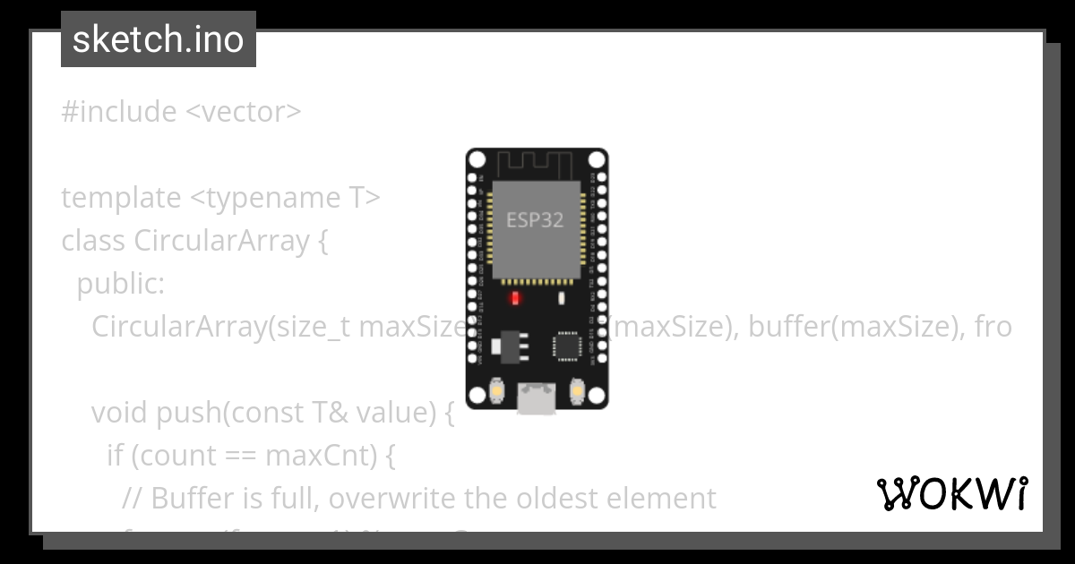

if you run on a 32 bit platform you could use the vector class to make a circular buffer

then you decide how deep your running average should be say we keep the last 10 elements and the type of data you keep in there (say double) and you create your 2D array of the circular buffers
constexpr size_t Rows = 5;
constexpr size_t Columns = 5;
constexpr size_t N = 10; // Maximum number of elements to keep for the rolling average
// Create a 2D array of CircularArray objects
CircularArray<double> circularArray2D[Rows][Columns] = {
    {{N}, {N}, {N}, {N}, {N}},
note that you could decide to have some elements in your 2D array registering more values
now when you want to save an incoming value into the array you use push()
circularArray2D[y][xl].push(aValue);
and when you want to compute the average for a given (x,y) entry you call
circularArray2D[y][xl].average();
here is an example with one circular buffer
click to see the code

Sorry, I'm not following how that helps?

the code with the circularArray could
Thanks but to be perfectly honest, I don't understand the example enough to implement it!
You've lost be with what a vector class is...
This is a good example of code where there seem to be a step-change in programming complexity that I can't get my understanding past. If its in Arduino Reference then I can generally work it out and/or search for examples on the internet. But there is so much stuff here that I don't recognise, it seems to be impenetrable to decipher! Is this where things become more based on C (or C++)?
