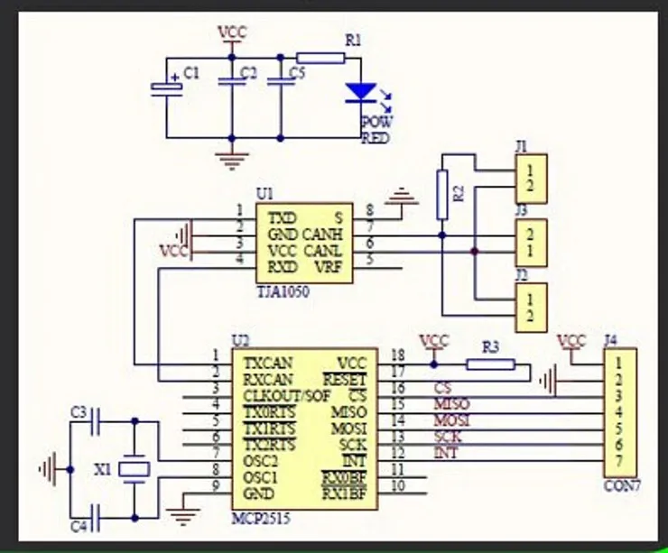

I'm trying to receive CAN DATA from Arduino UNO with MCP2515 Module.
I'm not using CAN-BUS Shield and am only using MCP2515 Module(MCP2515 CAN Controller with TJA1050 CAN transceiver. (Attachment #2))
http://www.aliexpress.com/item/MCP2515-CAN-Bus-Module-Board-TJA1050-Receiver-SPI-For-51-MCU-ARM-Controller-NEW/32581650373.html?spm=2114.01010208.8.8.aabjPj
I think that even though I do not use CAN-BUS Shield, I should be able to receive CAN DATA through the MCP2515 module because it includes MCP2515 CAN controller and TJA1050 CAN transceiver.. Is it right?
Here is my test environments:
  1. Arduino setting: Attachment #1
    OBD2 16pin cable => 6pin(CAN HIGH) and 14pin(CAN LOW) => MCP2515 CAN Module => Arduino UNO
  2. CAN Module: Attachment #2
  3. Vehicle : VW Tiguan
I connected several pins between with Arduino and MCP2515 module like below:
Arduino MPC2515 module
5V VCC
GND GND
13 SCK
12 SO
11 SI
10 CS
2 INT
I downloaded MCP_CAN_LIB source files.
And I opened a "receive" example of MCP_CAN_LIB from Arduino IDE and initialized like "CAN0.begin(CAN_500KBPS, MCP_8MHz)" because my chinese clone MCP2515 moudule is using 8 Mhz crystal.
But I could not receive any CAN DATA.
The function "digitalRead(2)" always returns HIGH..
Has anyone got this problem?

I have the same setup (Arduino Uno -> MCP2515 -> TJA1050 -> ODB22 pin 6 and 14), and trouble receiving messages from my Peugeot 207.
Connection from the Arduino to the MCP2515 seems to be just fine, but I'm just not receiving any messages. Now I see the register modifactions mentioned here, but I don't really understand them. Could those also be my problem? Do I need to modify the library as well?
Are you positive this vehicle has CAN? The best way to tell is whether there is a physical contact for pins 6 and 14 on the OBDII port of the vehicle.
What baud rates have you tried? FYI, 250k & 500k are OBDII standards.
Does the board you have come terminated? Remove it if so! OBDII does not allow a scan tool to have a DC termination. Also, keep in mind the cable length shouldn't be any longer than 1 meter.
Have you tried swapping the CAN connections going to your the OBDII port? Eg, the polarity is wrong: CAN_H and CAN_L are reversed and this condition needs corrected.

Yes, I'm sure. It is a 2008 car and it's mentioned in different specs. Furthermore, some people have been able to hack into the CAN bus for this vehicle, as can ben seen on Youtube (unfortunately they don't respond to my messages for more information).
coryjfowler:
Yes, I have tried both.
coryjfowler:
The board has a jumper to terminate the connection. I've used the board unterminated. See these schematics.
coryjfowler:
I have tried, but it actually made the instruments go crazy etc, and I got various diagnostic errors on my dashboard (which disappeared after running the car for a while).
Have you tried sending an OBD-II PID request? I'd try at 250k first. It could just be that the port has a CAN bus dedicated for OBD-II and nothing is broadcast over it. Outside of that I would investigate your hardware. The fact that reversing the polarity caused an issue tells me the port is active in some sense.

So I tried connecting a module to the CAN bus wires of the radio (per this schematic, for example). But this gave some strange results;
  • First, I measured the voltages of these wires, and they are actually the other way around from the schematics. Connecting by the schematics resulted in random dashboard errors. Connecting the other way around gave no errors, but also not one message. I tried different baud rates, 125k, 250k and 500k
  • The voltage difference in the radio CAN bus wires is much higher than on the ODB2 port. On the radio I'm measuring 4.58V vs 0.34V. On the ODB2 port I'm measuring 3.13V vs 2.36V. So apparently this is not the same CAN bus.
I'm actually quite lost now on what is happening here, and how to proceed :confused:

reynard80:
Did those wires appear to be twisted together by chance? That's usually a good indicator of some type of digital bus. Also, its not unheard of for extra CAN buses to be populated on the OBD-II manufacture's discretion pins. My old Escape had two and my new Jeep has three on the port. (I found them via trial and error.)
At this point, I'd say you'd need an oscilloscope to see what is actually going on between your car and the CAN module. Something just isn't right and its interesting that they work fine together, but not with your car.
