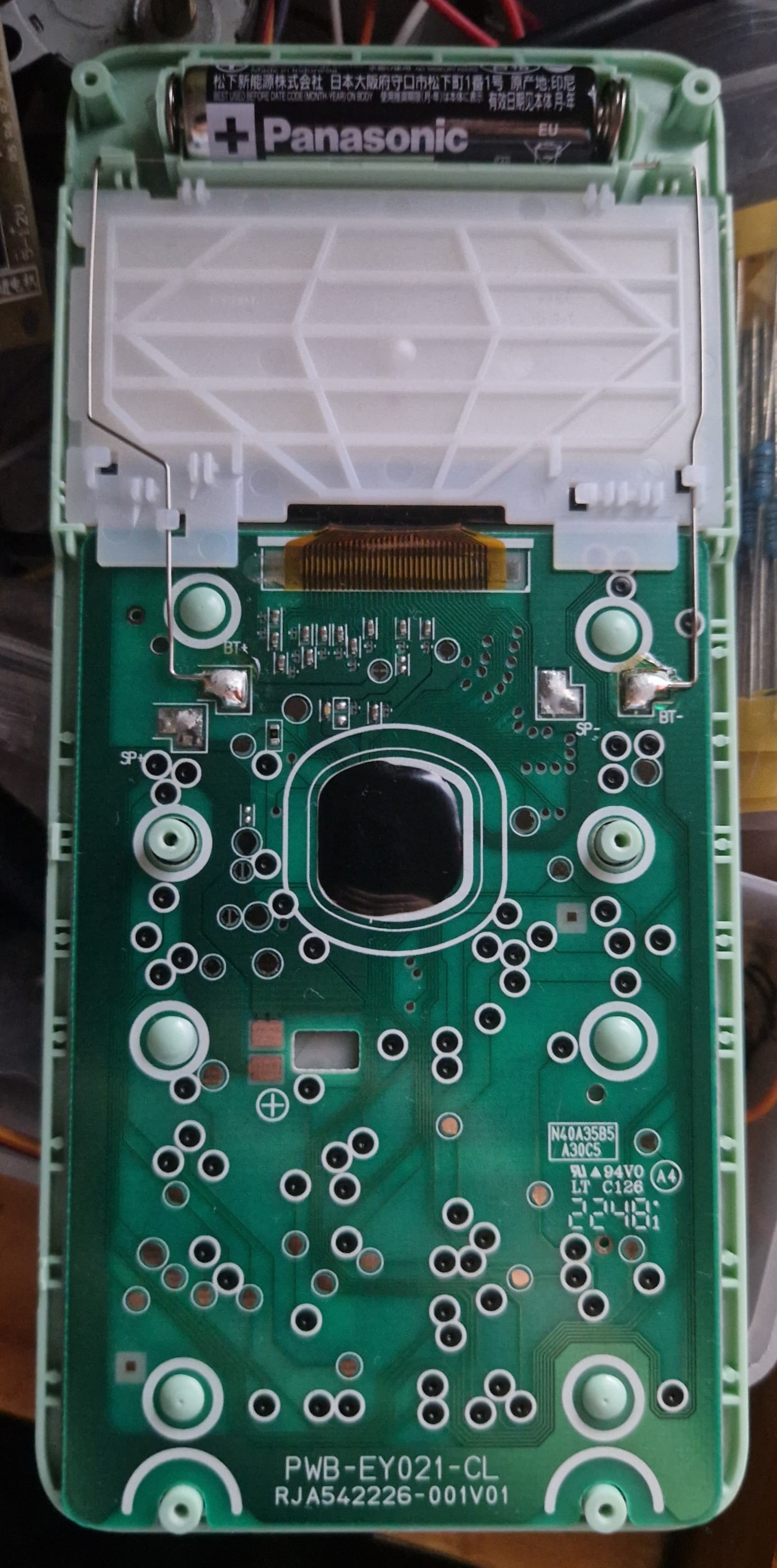

I'm working on some project with a device I disassembled (to be more precise, a calculator) and need to read voltage from

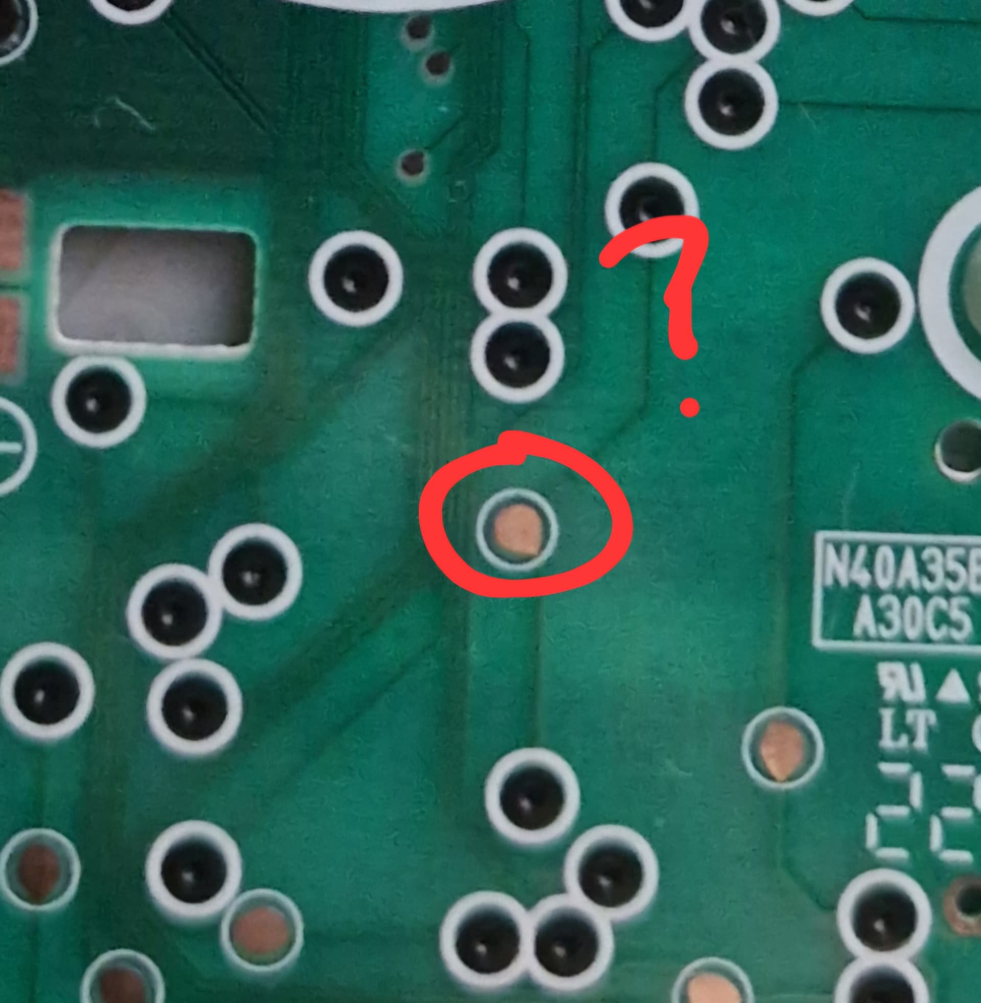

on its PCB (and, if possible, send current to it). I want to start off saying I cannot read boards, but I do have knowledge about electronics and tech in general. The device has contacts that, when connected to an oscilloscope, emit a short high spike when a button is pressed.
The device's power rating is 1.5 volts, and is powered by AAA. and I wonder if the Arduino can read such low voltage.
If you need more info, please let me know!
Thank you for your help!
The board:
(example contact: )
