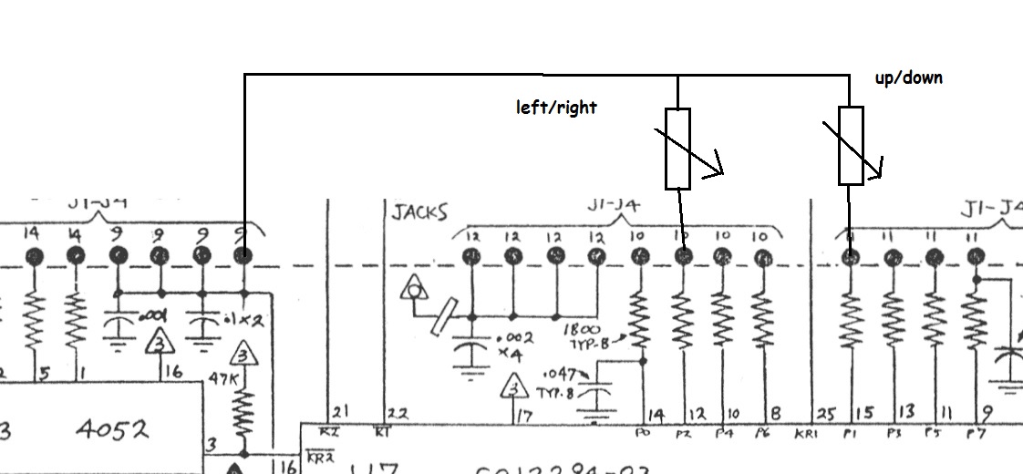

Atari 5200 custom controller. The stock controller has crappy non-centering analog stick, 3rd party sticks are pricey, and no one makes modern joystick that can be used directly on an Atari 5200. I was hoping the modern $1 counterpart that is usually available in 10k and maybe 100k range can be used somehow without modding the console to change the reference voltage. Atari 5200 uses analog control as voltage divider to calculate position, and uses only half of the 1M ohm potentiometers between low and high side.

The pots common for Atari joystick is not 5v or 0v but it's set at a different voltage using resistor and a variable resistor inside the console. I have no idea how would ATari 5200 behave if I used a 10k joystick in it instead of the expected 1M ohm. I suppose I can try but I bet Atari 5200 would perceive the stick is being held up and left and not register any movement closer to the original center no matter what angle I hold the 10k joystick at.

The ones you found isn't for Atari 5200, it's for 2600 or 7800. Try this one: https://atariage.com/5200/archives/schematics/Schematic_5200_Accessories_High.html for the controller, and https://atariage.com/5200/archives/schematics/Schematic_5200_IO_High.html on the bottom left side the the joystick centering circuit. There's a couple resistors between ground and common leading to controller ports, and some more resistors and transistors around that centering circuit I don't know what it's for.
:slight_smile: Very different from the Atari Joystick circuits I found! Presumably the 1M variable resistors you are taking about are those with no value marked at up/down and left/right. Seems most peculiar to me since in that form i would expect very non-linear and asymmetric control. The asymmetry might be ok for up/down but not for left/right . There is more to it than those diagrams show since I don't see any value for those resistors. Without access to the hardware I suspect I can't help.
It looks like they use the "joysticks" as variable resistors with U7, instead of the more efficient potential divider.
