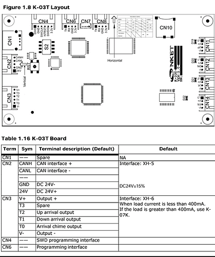

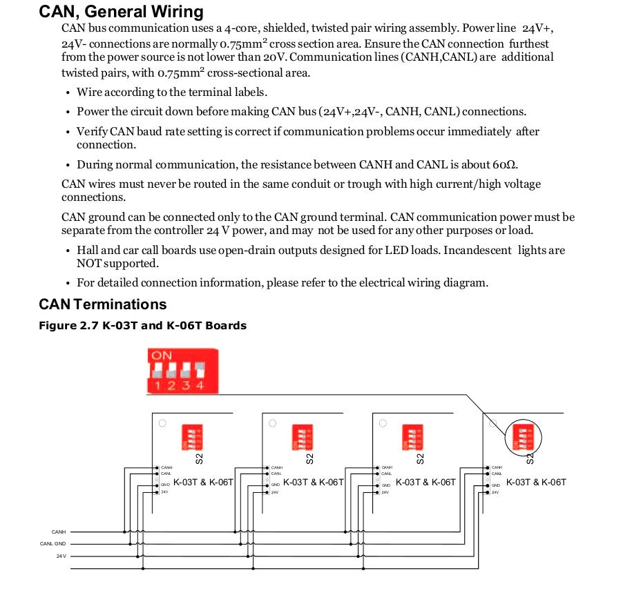

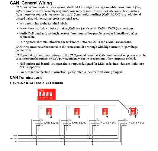

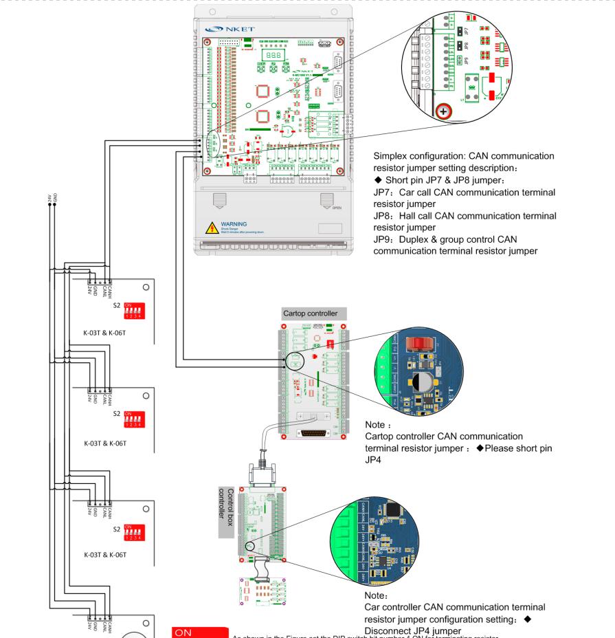

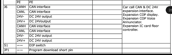

Here are some more pics about the connection of the devices as described in the manual
It does not matter, if it's CAN compliant then you can in theory connect your module.
