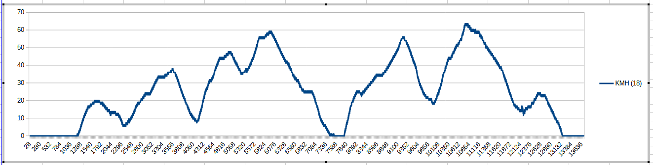

By analyzing the CANbus of my motorbike, I located the speed data byte (sent by the ABS module).
The message ID 0x268 is sent every 10 ms and the Byte n.2 is the speed, but....
It takes the values ​​0, 1, 2, 3, .... which correspond to 0, 18, 36, 54, .... [km/h].
Now, the passage from one speed to another value is determined by the frequency of the respective raw data.
Example:
9 km/h (18/2) is obtained by alternating every 10ms the value 0 and 1.
If the 1s increase compared to the 0s, the speed increases and if they are only 1 to reaches 18 (threshold speed for raw data 1).
32 km/h is obtained by alternating more values ​​2 to the values ​​1.
Can you help me figure out how to get a formula for correct decoding?
I attach a log file of this message.
Raw speed data starts at about 12,000 milliseconds. I was standing still before.
log1_speed_csv.txt (363.8 KB)
(updated)
Raw data of B2 column

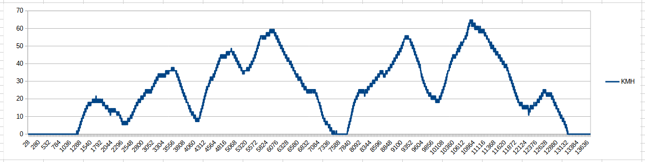

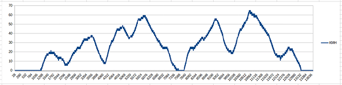

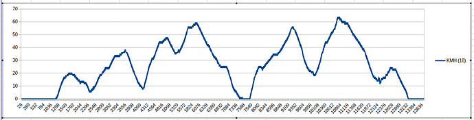

Take the average of the last 10 (or 20) measurements.
This will give a smoother graph of the speed
more points in the running average will result in a higher resolution,
but it will react slower on changes in speed.
(and yes you have to multiply the running average by 18 km/h of course)
As 1 = 18 km per hour,
you need to have a running average buffer of 18 to get a 1km/h resolution..
