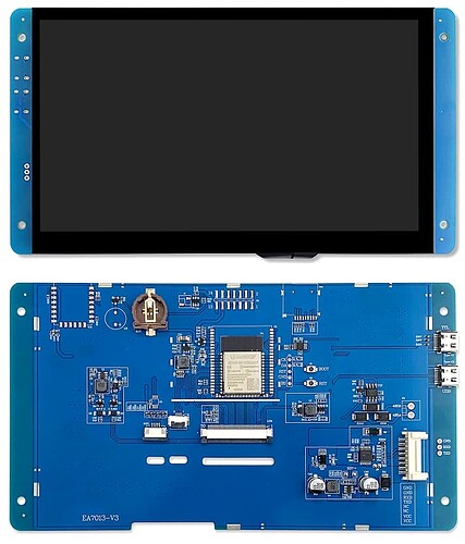

Yep, I think they've put it here because of the tft models that is using the interrupt pin. Which is what I've having with the display model I have which is this one:

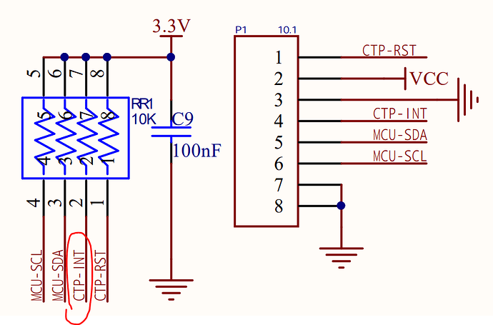

This is the schematic of the pins connected to the capacitive touch driver:
When I run the example code, of the TAMC_GT911 library, it doesn't work. That's why I think it's conncted with the interrupt pin.
I have another ESP32 display using the same touch driver but not using the interrupt pin, so the display works fine.
So I thought I must enable the interrupt function of the library. So as you guessed, you're right, I uncommented and found this problem.

Well, the first problem is that the pinInt was left pulled to HIGH all the time. That's why the display was in interrupt mode all the time.
I pulled it LOW, and commented:
attachInterrupt(pinInt, onInterrupt, RISING);
And it's working. It would be nice if I can figure out re-enabling the interrupt functionality in the future, but now I'm quite happy I got it to work.
One issue I found, is that putting pinInt in input mode, locks the display in constant interrupt mode, even if I'm not enabling attachInterrupt function.

So, commenting pinMode(pinInt, INPUT); leave the pinInt pulled down and problem solved.
I have another question, since configuring this pin to be input will cause the ESP32 to be locked and can't process any code, I thought of pulling this pin to LOW with a resistor. Like this:
