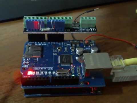

Cannot power up Arduino Uno + Ethernet Shield with other than computer USB
I have successfully wrote a sketch for Ethernet Shield and Arduino. If I plug it into computer's USB, it works.
But if I plug into any other power source, like USB power adapter from iPhone or laboratory power source to power socket -- it doesn't work.
LEDs are doing various strange bursts, very different than if powered from computer.
What can be the reason?

The situation is the same:
It is plugged into Samsung tablet USB power of 2A, so insufficient current is unprobable reason.
I also tried to remove inclusion of SPI.h
If I connect another Arduino board (but of the same vendor, it is from AliExpress), the behavior is the same.
I have compiled blink example and it works in any combination. If I connect Ethernet shield, then it blinks with both LEDs on Arduino board and on Ethernet shield.
I bought different Ethernet Board and it doesn't work too.
Please help. Have anybody ever powering Arduino + Ethernet not from USB?
Improper grounding I suspect.
ieee488:
How to make it proper? How it appears proper with computer USB?
