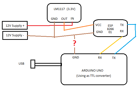

I'm making a project with esp8266-01 module. Schematic is attached. It shows only required connections for this question.
I'm using arduino uno as ttl converter. I intentionally connected tx to tx and rx to rx, there's no mistake. I want to use this circuit to upload code to esp8266. My question is, should I connect gnd of arduino with the gnd of esp8266? I know i should connect when i use arduino normally, but as I'm using it as ttl converter (I connected gnd to reset) I'm not that sure.

Yes you need to connect that ground

Why connect 2 transmitters, Tx, to each other, and the 2 receivers as well? What pin will receive what Tx is sending out?

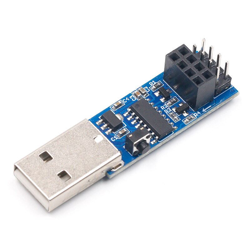

Come on now! Make it easy on yourself! Buy a proper dedicated (cheap) ESP-01 programmer,
Aliexpress item
It's not just the problem with the ground in your diagram in the first post - connecting directly to the Arduino UNO may put excessive voltages on the ESP.
Do you realise you would need capacitors on the LM1117? And probably a heatsink?
How were you going to put the ESP-10 into programming mode? The module I have shown does all these things correctly and automatically. :sunglasses:

It is presumed you will be disabling the UNO's mega328 by shorting Reset to ground on the ICSP connector (jumper two pins nearest to the 328).
