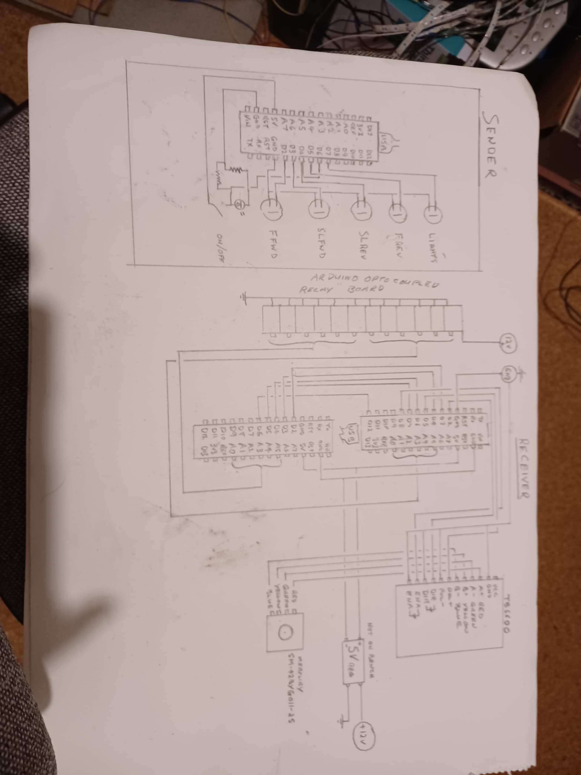

Can't get digital out on D9,D10,D11,D13
Jim

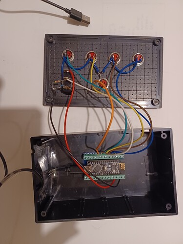

I just tested the sender box and all buttons from another room in the house and it connected and worked fine. So my only question at this point is do you have any comments about the code.
Then I would like to move on the receiver code and motor and lights driver setup.
regards
Jim

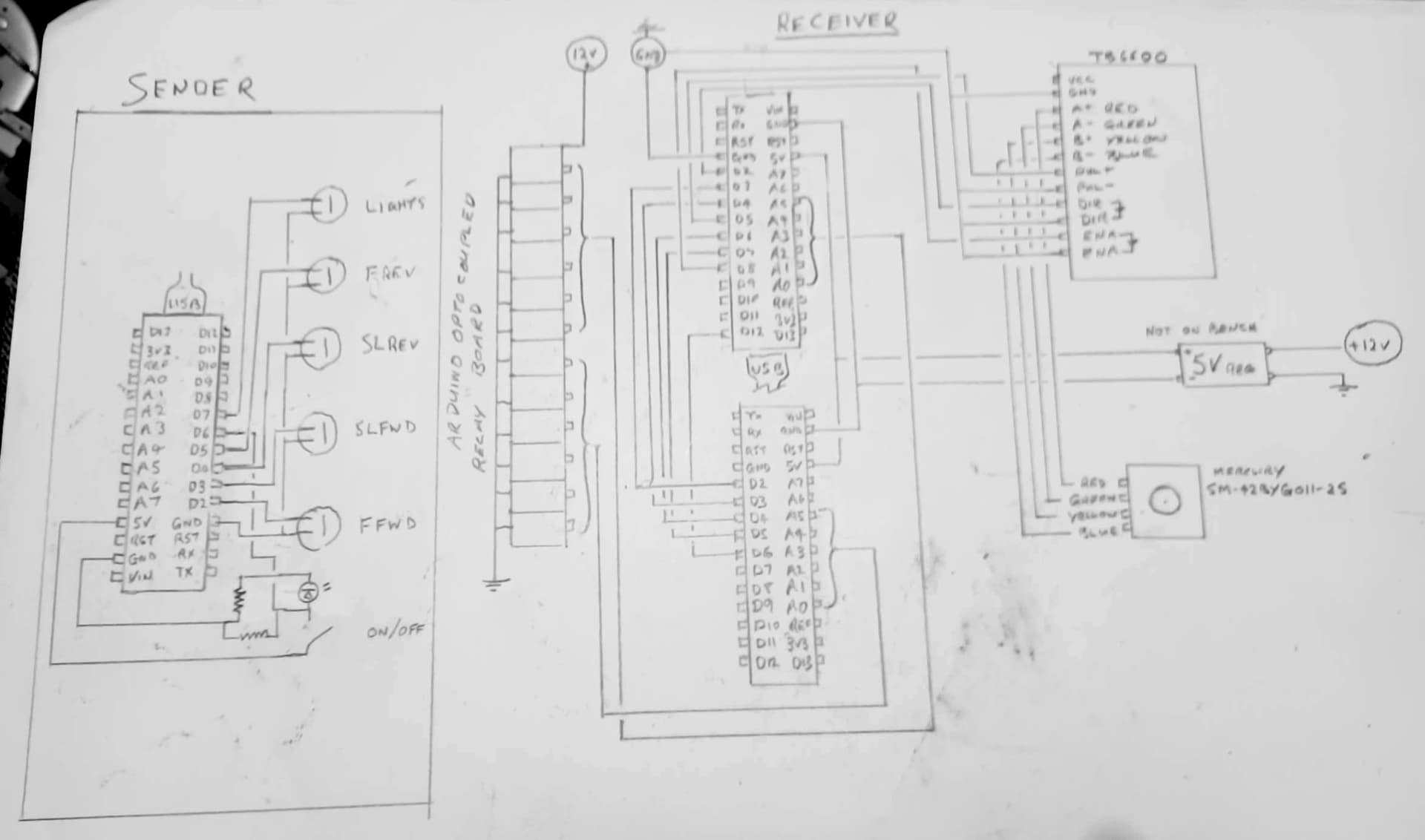

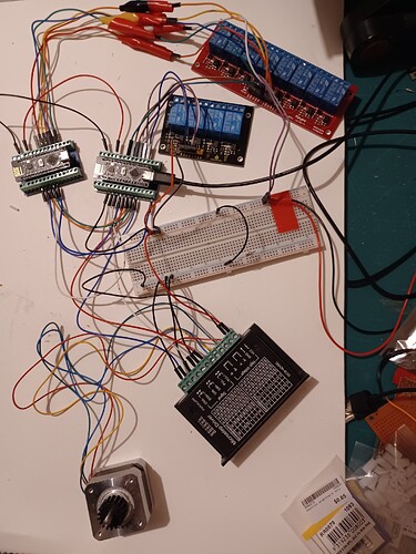

The receiver in the clock ran the Nema 17 stepper motor originally by a Microstep Driver TB6600 RR-2B-RAP controller. Thgetting fe whole clock is powered by a 12 volt battery later to become a 12v 6 amp witch mode power supply.
It was only after I set up the Arduino Nano RF digital and analogue outputs to switch 12 off 24 LED white strips I found I had problems.
  1. Could not get full brightness with digital outputs while analog outputs worked fine but I only had 6 available A0 - A5.
  2. Although I could drive with signal transistors even then the digital outputs did not give full brightness
  3. So that is when I went for opto coupled arduino relay boards to switch the 12 light strips but only the analog outputs would drive them direct and the power required was ok for all 6 to be on together
  4. So I needed 6 more analog outputs and decided to use another arduino nano without RF hardware to do this by sending it a binary number from 3 digital pins on the clock chip directly connected to three pins of the second chip (8 codes)
  5. I was getting very curious results like not all relays were on when commanded and even changing the chips and swapping pins certain outputs were not going HIGH?
  6. Checking on two different relay boards made no difference so there was no fault on the boards or the processor chips?
The next problem was after connecting the stepper motor and controller as previous before the lights experiment to check overall operation I found the motor not responding except by just dithering back and forth on step commands. So I tried all different delays on the stepping command to give the electronics time to settle and reduced the cycle time t no avail. So I just went and bought another controller and set it up using the library [#include stepper.h] only to find exactly the same result! So I am now about to order a new motor unless someone can tell me otherwise like perhaps the RF is inducing crap in the controller signal wires and its not the motor. But of course that should have occurred before the light experiment.
So here is the code on the clock (receiver) chip using commands for the second controller with those for the first commented out.

Can you show a wiring diagram, the description and code are somewhat confusing.
Is your stepper driver connected to pins 2, 3, and 5? You appear to be using pin 3 for one of your relay signal pins to the 2nd arduino board.
You have not set any of the digital pins to output mode, as well as a couple of the analog pins (A4 and A5).
This is totally wrong, A6 and A7 are analog input only on a Nano:
< edit >
Can you post the original code with which the stepper motor worked? The Stepper library does not seem to be compatible with the TB6600 stepper motor driver.
Thanks David..
The wiring is changing as I test various combinations on the bench using a breadboard so I am trying to show only real problems one at a time. If you look at the thread my reply to jim includes all the code except I have now rearranged the case statements from 1 through 7 in order just in case my putting 7 before 5 and leaving out 6 was a cause of any logical bug.

I suggest to fix everything step by step. Start with the hardware. Do you have a schematic ? Can you draw on a piece of paper how it is wired. Can you give links to the relay module and all the other parts ? Can you show a photo of the project ?

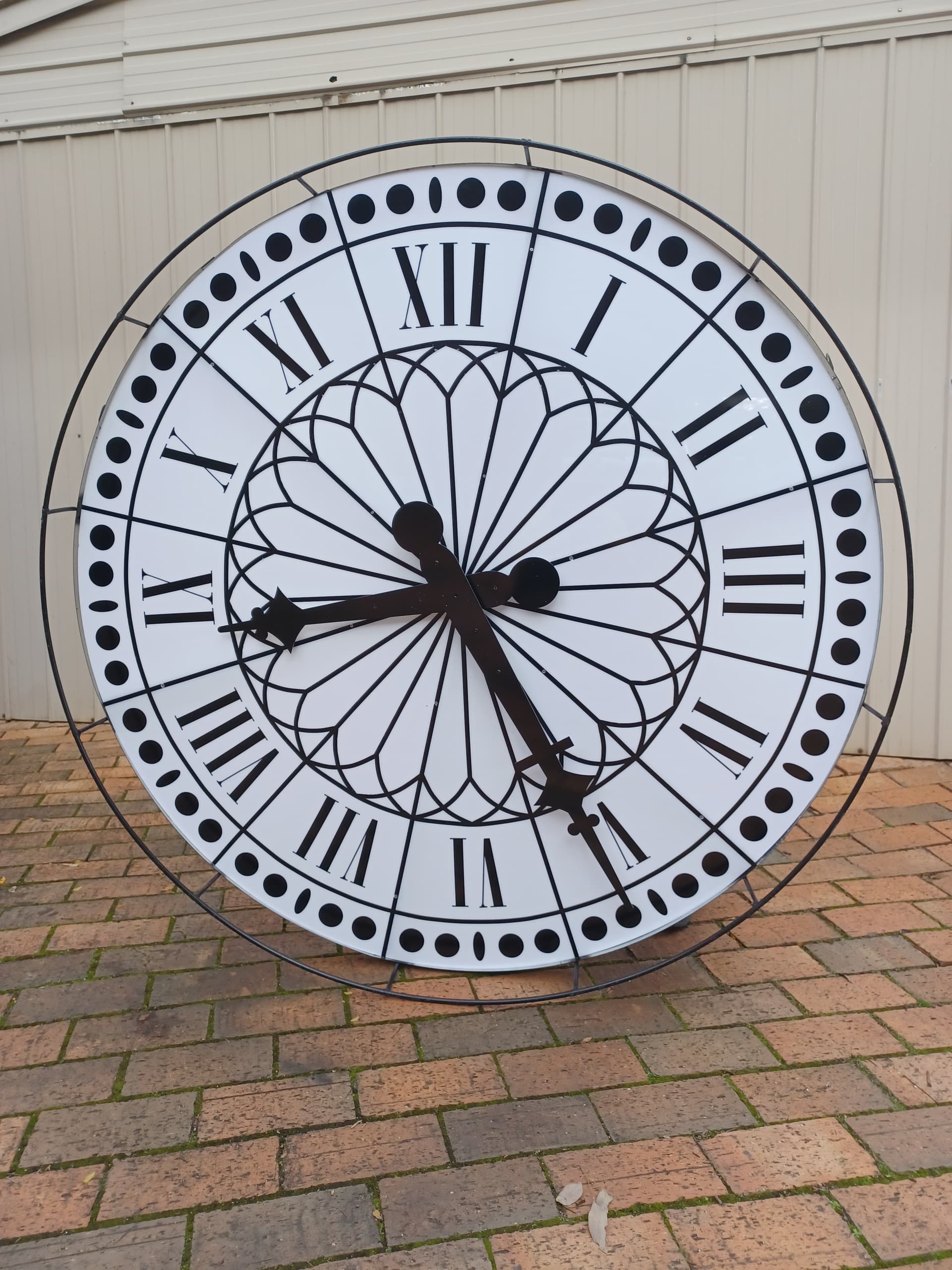

Here is the clock it's 1.5 M in diameter.. time is not right because the gearbox has not been assembled.. which is awaiting the electrical components.
And here is my bench setup..
Here is the sender box..
Here is the code for the sender box which I know is the source of the problem because when the USB is unplugged the spurious "7" signal stops s it is not in the receiver on the clock.

Here is the circuit diagram for Receiver (clock) and Sender (5 Buttons and one switch). The switch is intended to turn out the lights and stop the clock.

Your switch wiring should be ok, you have a pull-down to ground.
