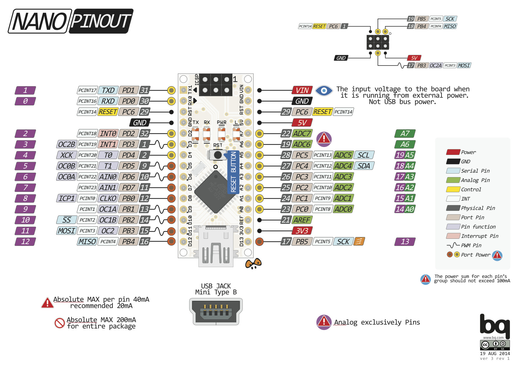

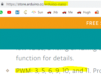

The nano reference page tells us these are its PWM pins:
3, 5, 6, 9, 10, and 11
So pin 8 can't be working as expected if you say it's PWM-ing, it's impossible.
(Pin 12 won't work, it's not PWM; 3 and 11 should though.)

@neiklot
Those are the pin labels; not the pins.
The actual pins are 6, 8, 9, 12, 13, & 14. D12 is pin 15. I’m looking at the pinout for the Nano!
Pin 3 on a Nano is the Reset pin. I doubt it’s used for PWM.
I think you’re confusing the Nano with the Uno pinout.

Wait a minute! Go back to my first answer to you. 3,5,6.., are the numbers of the DIGITAL pins, not the actual pin numbers. You are referring to D3,D5,D6...
The actual pin numbers are what I listed.
Look at a picture of the Nano. Pin 3 is an INPUT and used to reset the processor. I doubt strongly that it is a PWM pin. If you look, D3 maps to pin 6. Since pin 3 cannot be an output and it so happens that D3 is a PWM output and is in pin 6, I’m still unconvinced.

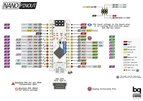

for NANO PWM pins refer to this diagram:

@wolframore and @neiklot,
Ok, that last pinout is different than the one I posted. I had hoped for this. Meaning, an easy to fix scenario would be based on a pinout confusion. I’ll test it tonight.
Thanks for putting up with a stubborn old man.
It's very unusual to talk about pins on a board like Uno or nano other than by the numbers printed on the board.
I have never once, in 7 years of playing with Arduino, referred to a pin by any other number than those printed on the board.
So look at the text in the pic you linked at circuitstoday: the ones labelled "PWM" (which on an Uno are marked ~) are D3, 5, 6, 9,10 and 11. Those are the numbers in the page I linked, and are the numbers used in pinMode() and the various write and read commands.
To me, they're the only numbers in play.
