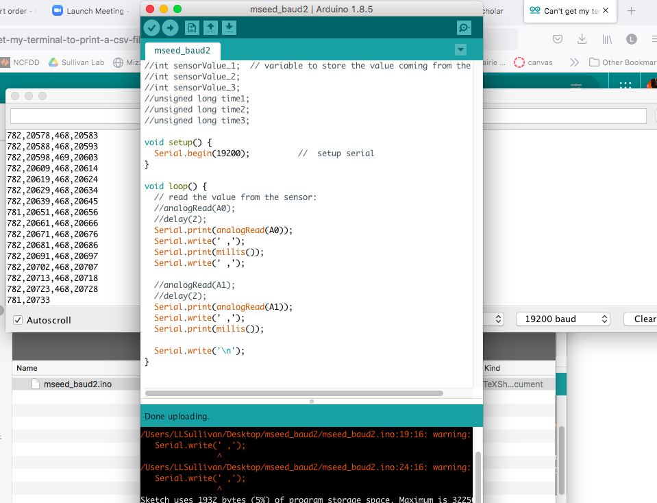

Ok thank you all! I have attached my screenshots. I think they are working?!
  1. the screenshot of the arduino code so you can see baud rate and that the Arduino is collecting data in the background, I assume at the correct baud rate.
  2. screenshot of how we run the arduino on terminal and print out put
  3. screenshot of the actual output where it starts to record, then gets to be garbage after a bit. I will not that lines 1-15 are what we usually get, and those weird numbers there typically stop after some burn in time. So we just cut that out typically when analyzing. But the weird characters starting at line 16 aren't usual.
Does that help??

fix this, everywhere. Should be
Serial.write(" ,");
how does the difference in "/' make a difference for one baud rate and not the other?
Don't know, but doing something incorrect should be corrected. Serial write expects a null-terminated string, the way you're using it, or a single literal, a char, 'c',
If you don't know the difference there, it's time to hit the books. No slight intended.
edit - Since you came here looking for help, maybe try it, and see if it helps?
For one thing, writing garbage into the serial buffer is sooner or later going to result in garbage out. So there's that. The rubbish you're seeing later in the run is typical of a serial buffer run amuck, transmitting whatever it finds in memory. So...

The second screenshot shows the terminal still set to 19200.
well spotted!
