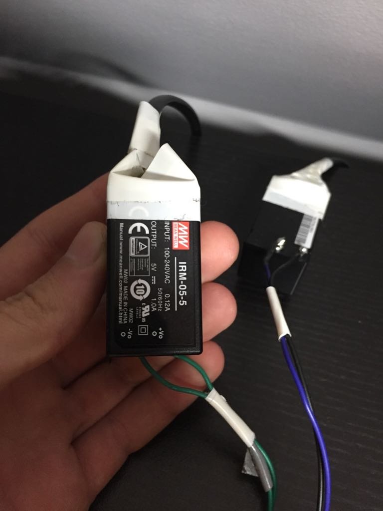

I've recently bough a voltage regulator named LD33V and I did a circuit like this one (I don't have the 1117. I have LD33V):
Now I have a stable power supply that gives me 3.3V- 800mA.

I get data now but it's not readable at all. I'm attaching some pictures of the new power supply circuit. I have also added a 10uF capacitor on each nRF.
Capture 1
Capture 2
