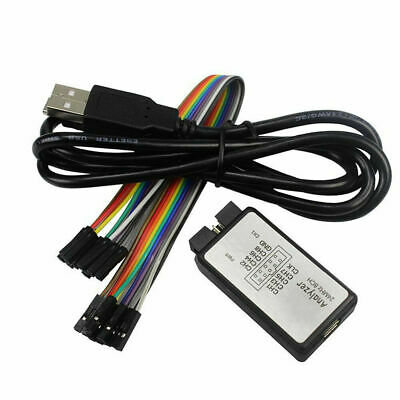

Not sure if this would help analyse especially this problem.
There are 24 MHz 8 channel logic analysers to buy that work very well un conjuction with a freeware called PusleView. This freeware PulseView can analyse and decode a lot of protocols
As they cost only 7 to 10 euros it is worth the price.
