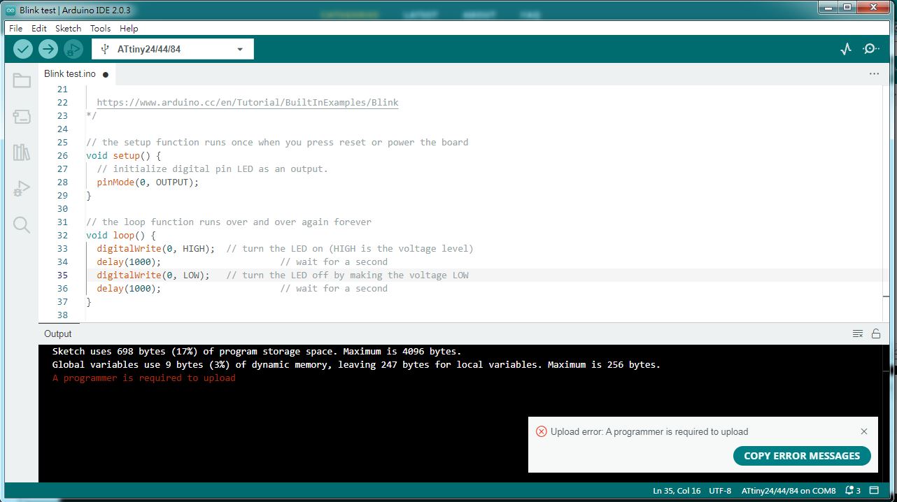

Can't upload sketch to Attiny44 always have error
Always have "A programmer is required to upload" msg, anybody can help me?

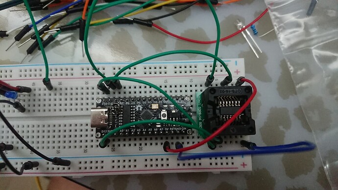

Connection photo
I don't see another wire and capacitor for the RST signal
