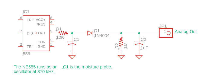

Good day All,
This is my first time posting to this forum and kind off my last resort as I would've liked to figure it out myself. I am trying to create a soil moisture probe which can be used on farms to determine soil moisture at different depths. The project consists of a Arduino Nano, a DIY capacitive moisture reading setup (schematic attached- My setup is the same except for the LED moisture indicator)) and an LCD screen to display the required value.
My initial setup was a Arduino Nano (328P Old Bootloader) with a resistive soil moisture sensor. However, these sensors (as they are resistive) do not give reliable readings when measuring at different spots in a field. I believe it is largely influenced by pH, salt content etc.
My next approach was to build a DIY capacitive soil moisture sensor. After searching the web I came across a setup on hackster.io ( Arduino Capacitive Soil Moisture Sensor (DIY) with ESP32 - Hackster.io ) where a signal is sent via a ESP 32 microcontroller to a probe in the soil and a signal is returned. I implemented the same setup with the same components however I only used optimization of the timers on the Nano to generate the PWM wave (Once again this code was also obtained from another website and I am still a bit confused on how the code works).
I seem to get a reading from the sensor but the zero value seems to very volatile. Even if the wire is only picked up, the output reading changes. Is there a way to get around this and can someone please help me to get my system working optimally.
It would be highly appreciated.
//The setup uses a Chinese Arduino Nano, a 10M ohm, a 10k ohm, a 1N4007 diode and a 1 microfarrad capacitor as shown in the schematic.
//The LED moisture indicator in the schematic can be ignored

Please, no, can you please put that aside ?
  • Never call a Fritzing drawing a schematic, that drives some of us nuts :wink:
  • The circuit is not a capacitive soil moisture sensor. It is mainly a resistive soil sensor with a DC part and a part radio wave. Because it is not AC, the probes will oxidize.
  • I doubt if you use Timer1 correctly.
  • I don't understand the calculation in your sketch.
  • One wire of the probe is connected to the GND of the Arduino. That can cause issues when it is not powered by batteries or when more probes are used.
I'm sorry, but that is not the way. I'm afraid it will never work :frowning:
For the Arduino Nano you can use the tone() function to generate a frequency. I forgot the maximum frequency it can do.
Sometimes I use the toneAC, I think it can go up to 1MHz.
There are other good libraries as well.
If you use capacitive soil moisture sensors with analog output, then you don't need a high frequency signal.
You can buy capacitive soil sensors with analog output which are waterproof, or buy normal capacitive soil sensors and use heatshrink with glue to make them waterproof. Don't buy the cheapest capacitive soil moisture sensors, they have issues.
This is an example of such a sensor: https://www.tindie.com/products/pinotech/soilwatch-10-soil-moisture-sensor/.
If you are a beginner, you should start with something that works.
A if-statement and for-statement don't need a ';' after the closing '}'.
Below is the schematic of the Fritzing diagram, so others can rant about it as well.

This is not a complete schematic, but this is how the capacitive probes are made:
Basically, the NE555 is operating as an oscillator and the capacitance of the probe changes the analog value out.
Don't be confused by the name - the soil has no capacitance to measure, only conductivity. The capacitance is only a method of isolating the soil from DC currents. The meaning of that is - the measurement is actually a resistance measurement, taken in series with a very low value capacitor. Hence the high frequency, to reduce the impedance of the capacitive component so it doesn't contribute much to the reading. So, in the diagram above, R1/C1 is effectively working as a resistive voltage divider, and that is why the rectified output voltage can indicate soil conductivity. Any circuit that you design has to follow this basic plan. The sensor itself has this kind of model:

aarg:
terminal1 0-----||-------(soil resistance)-----||------0 terminal2
The capacitive sensors work by varying the capacitance of the probe. Wet dirt adds less capacitance than dry dirt.
Thanks all for the feedback. I will be trying the 555 oscillator circuit to see of I can recreate a reliable sensor. I know about the commercial capacitive soil moisture sensors, however these are not practical for what I am building as the probe needs to measure moisture at depths up to 1m. Taking into consideration that a housing will have to be built in which the electronics can be protected whilst probing up to a metre deep, makes these types of sensors unpractical. Thus a control PCB will have to be built which relays the data of the 3mm probes that are at the tip of my sensor "stick"
There is always some loss in a dielectric medium, wet soil is very lossy. Also if you look at the capacitor "plates" on the ones I'm seeing from a search, they are placed adjacently in the same plane, reducing the capacitive coupling considerably. I think this must at least introduce a significant dependence on the conductivity of the medium in this case. Either way, if the measurement electronics is separated from the sensing elements by a meter, care has to be taken with the cable. It should be shielded, and have low capacitance.
