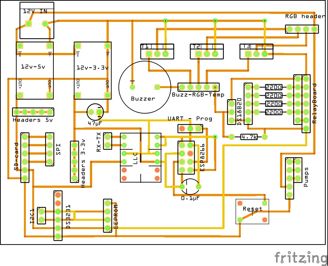

Hello,
I'm working on an aquarium computer project. And I'm almost at the point of going from breadboard to PCB. I'm thinking of making my own PCB for that, and I've tried to design one with Fritzing.
It will be connecting my Arduino Mega, the ESP8266-01 wifi-module (with a logic-level-converter, prog-uart switch and reset button), an EEPROM adapter, an SD card reader module, RGB drivers, a buzzer, DS3231 RTC, connection for my pumps, relay-board (and leds), temperature meters, 2 dc-dc converters, and some extra 5v and 3.3v headers.
So far so good, but after reading some tips for the use of capacitors in combination with the ESP8266 wifi-module, I figured it would be a good idea to add some. So I've added a ceramic 0.1uF close to the ESP8266, and a 47uF electrolytic aluminium capacitor in between my 12->3.3v dc-dc converter.
But this got me thinking: Wouldn't it be a good idea to put in some more capacitors. So I've started reading on the use of capacitors, but so far I still don't have a clue of which capacitors I should use, and where to place them...
So I'm hoping that someone here can help me...
Should I, for instance, place another 47uF cap after the 12->5v converter. And some before the dc-dc converters? Or should I use different capacitors?
The two voltage regulators need both an input and output capacitor. It should tell you the values in the data shee. Make sure the data sheet is by the same manufacturer as the actual part because actual requirements do differ.
Also I would put a 100uF across the 12V inputs to each led strip.
Add top & bottom layer ground plane, vs distributing it via traces.
Post your schematic as well - not the picture of all the components.
Are those switching (buck) voltage regulators, or linear ones? If switching, they should already have a filter cap on them, and you probably don't need another one. If they're linear, use the type and value of capacitor specified in the datasheet, one on input, one on output - some linear regs are very picky, others aren't, and most care what kind of cap (electrolytic, tant, or ceramic) is used. You may choose to add additional electrolytic caps to the output, but I recommend it only if you've determined that there is unacceptable ripple on the output of the regulators. If using a linear regulator with long wires/traces between the 12v supply and regulator, I'd throw on an electrolytic cap on the input (say, 100uF to 470uF) for good measure.
Every digital IC should have a 0.1uF ceramic cap across supply right next to it minimizing length of traces. Unless the datasheet specifies some other value. Even when the datasheet doesn't spec any decoupling cap, you probably ought to use one. For ESP8266 modules, especially the ESP-01, I would use a 10uF ceramic, not a 0.1uF one - the module already has 0.1uF ones; what it seems to lack is a larger value decoupling cap (the sudden current surges that that module can pull are sort of shocking - it can go from 30mA to 300mA in an instant when it transmits.
And - yes, use a ground ground plane (aka pour) on both sides, except close to where the antenna of the ESP8266 would be; ideally you don't want any copper right around where it's antenna will sit, as that can reduce wifi performance.
You got good information on caps, I would also have all the header pin 1 in the same direction. ( all the horizon either left or right and all the vertical top of bottom).

Thanks a lot for al the input and ideas. Helps a lot, because a lot of this is new for me.
Yes, I'm using buck converters (the mini-360), and it does seem like the already have capacitors.
Does this mean I have to check the modules I'm using, to see if they have caps next to the IC on it? And if not, place one 0.1uF ceramic cap close to the vcc and gnd pin?
As far as I can tell only the relay module and the EEPROM adapter don't have there own caps...
When I google "ESP8266 capacitor" I see a lot of guys advising to add in a 0.1uF AND bigger cap like the 47uF electrolytic. Some even say to use a 470uF. So I don't understand why you are telling me to drop both and add in a 10uF ceramic cap. Can you explain this to me? (as you can see I'm obviously a bit clueless with electronics)

I guess you're absolutely right, but I started this project with an Uno, ran out of pins so continued with the Mega and later on I discovered the existence of the ESP8266 and decided to add this to my project as well for communication with the app I'm also building.
Looking at the PCB it appears you're using modules for all components, that you plug in, rather than the bare chips. Normally the capacitors are in place already on those modules, and there's no need to add any more on your PCB.
Also make sure you have enough space to plug in all those modules. The EEPROM and DS3231 appear to be too close together, but it depends on the size and shape of the actual modules you have.
Can I suggest you thicken up all your tracks, you have bought a PCB covered in copper and you are going to pay someone to take it away.
Try and leave as much copper on the board as possible, all your tracks could easily be twice as wide.
Especially any gnd and power supply tracks should be thicker.
How much current will the RGB LEDs consume?
Put some LEDs on the PCB to show your power supplies working, they only need to use 5mA for this application.
Ground planes are good idea and you keep copper you have bought on the board.
Also put your PCB name in copper on the board, and label + and - in copper on the copper side, it will help with any troubleshooting you may have.

Ok, I thought so but your confirmation puts my mind at ease. Thanks.
The modules should have enough space, but I will check everything on paper, just to make sure.

Good points! Will do that... Thanks for the input.
I'm using 3.5meter RGB 5050smd ledstrip, so I guess 4 amps in total?
I have already posted a image of my circuit, haven't I?
Will post a new one soon.
Coos:
Don't guess. Look up the specifications of your particular strip, as it depends on the number of LEDs per meter and the supply voltage.
Make sure your buck converter can do that current twice over (it NEVER hurts to down rate them, if anything it saves a lot of heat).
Make sure the MOSFETs(??) T1, T2, T3 can handle this current comfortably, and won't produce too much heat (check ON resistance, or if it's a BJT the forward voltage drop, to calculate heat production).
Use at least 1 mm, preferably 2 mm or even thicker traces for the power lines to these components. Or even thicker if you can.
Ground/power planes are very convenient as well. I usually put a ground plane on the back, power plane on the front. The two form a capacitor, which also should help in reducing noise.

I've only seen the PCB. Hope you have a proper, well readable circuit diagram as it's done with Fritzing which doesn't make me hopeful.

There is no buck converter between my power supply and led strip, it's powered directly by a 12v power supply, which is also feeding the buck converters. And yes, I'll make sure it can provide enough current.
And I've also made sure the MOSFETs (IRLB8721) can handle it.
