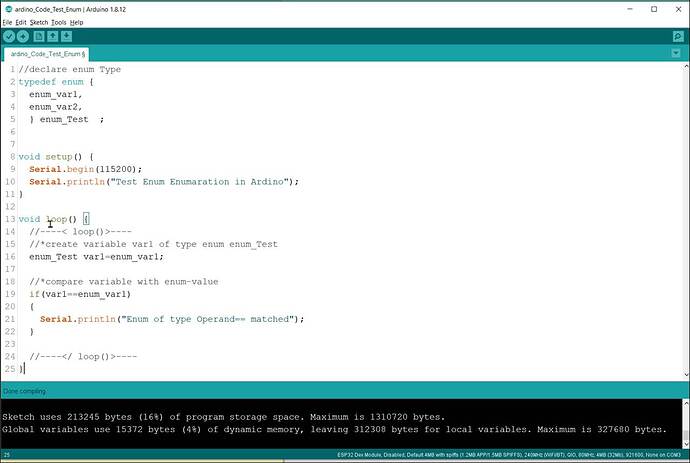

Hello,
you can make an enumeration for the errors to be used in the switch/case instruction.

Here are the new enum and double array.
enum soundEffects {
    alarm,
    alarm_high,
    alarm_low,
    Dev_startup,
    error,
    error1,
    noread,
    noreadings,
    normalrange,
    startup,
    startup_dev,
    update,
    warning,
    warning_high,
    warning_low,
void playWav (enum soundEffects effect, int volume)
