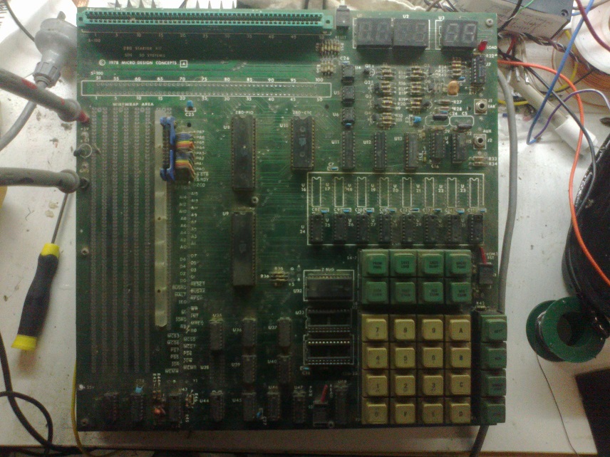

I've still got one of these, somewhere. It's got most of the components you talked about (no 8259, IIRC. My senior design project included implementing an interrupt controller with a couple of TTL chips.)
(and geez. Still obsessed with the BCD, huh... (I guess there's some value to seeing how it works on several different processors, once you've done one. But you've got 16bit registers, and 16bit math instructions including multply and divide. how about this oldie but goodie?)
