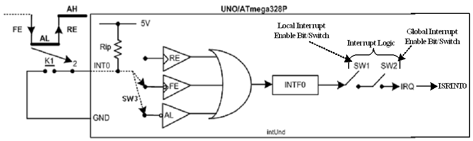

(2) Now, ask the MCU by pushing the external switch K1 to suspend the MLP of Step-1 and then blink LED1 (Fig-8.1) only for 3 times at 2-sec interval and then resume the MLP. "Blinking LED1" is a "side job" which is known as "Interrupt Sub Service Routine (ISR)". The symbolic name of the ISR in Fig-8.1 is: ISRINT0 (ISR due to interrupt at INT0-pin). Practically, the ISR routine should be as short as possible. Why should the ISR routine be short?
(3) The "external switch K1" is called an "Interrupting Device".
(4) When K1 is pressed down, the signal level of INT0-pin (Fig-1) of the MCU changes from HIGH to LOW; as a result, the MCU gets interrupted. The signal at the INT0-pin, which interrupts the MCU is called "Interrupting Signal". The symbolic name of the interrupting signal in Fig-8.1 is: IRQ0 (interrupt request 0). The HIGH level at DPin-2 (Fig-8.1) comes from 5V rail via "internal pull-up resistor Rip".
(5) The value of the interrupting signal is also known as "Trigger Level". The options for trigger level are (Fig-8.2):
(a) FALLING (falling edge FE),
(b) LOW (active low AL), and
(c) RISING (rising edge RE).
Figure-8.2: Interrupt trigger levels of ATmega328P MCU
Note: (a) At the presence of any event (LWO or FE or RE) at DPin-2, the INTF0 bit/flag of the MCU assumes HIGH state. This flag generates interrupt signal (IRQ) for the MCU provided SW1 (called local interrupt enable bit for INT0 interrupt) and SW2 (called global interrupt enable bit for all interrupts, Fig-8.8) are put into closed conditions (enabled states) in the setup() function. SW1 and SW2 together makes "something" what is called the "interrupt logic". More information on INTF0 flag could be found in Section-8.2 and datasheets.
(b) SW1 and SW2 becomes closed means "interrupt logic" becomes enabled when this code: attachInterrupt(arg1, arg2, arg3); is executed in the setup() function.
(6) In Fig-8.1, we observe that the ATmega328P of the UNO Board has two physical pins (Pin-4, 5) to receive interrupt signals from external sources. The symbolic names of these two pins ate: INT0 and INT1 which are connected with DPin-2 and 3 respectively.
(7) After interruption, the MCU will suspend the MLP and then will jump to ISR routine; therefore, a code should be executed in the setup() function to establish a relation/connection between DPin-2 (IRQ0 comes to INT0-pin of MCU via this DPin-2) and ISRINT0 routine. The following is the code that makes the said relation/connection.
attachInterrupt(digitalPinToInterrupt(DPin), ISRName, TriggerLevel);
==> attachInterrupt(digitalPinToInterrupt(2), ISRINT0, LOW); //for INT0 interrupt
Note: The above code also enables "interrupt logic (Fig-8.2)" so that the MCU is interrupted at the arrival of an interrupt signal. The "interrupt logic" is composed of:
(a) "Local Interrupt Enable Bit" represented by SW1 in Fig-8.2. It must be in closed position so that the MCU can be interrupted by an interrupt signal.
(c) "Global Interrupt Enable Bit" represented by SW2 in Fig-8.2, It must be in closed position so that the MCU can be interrupted by an interrupt signal.
(8) Let us note down that the MCU deactivates/disables "global interrupt enable bit" (means opens SW2 of Fig-8.2) before going to ISR routine so that it is not further interrupted until the current side job (the ISR routine) is completed. Also note that the delay() function needs active state of "global interrupt enable bit" for its own functioning. Therefore, it will not be possible to execute delay() function in the ISR routine. Now, the blinking job of LED1 of the ISRINT0 routine has to be done in the loop() function as "global interrupt enable bit" remains enabled in the loop() function. How will loop() function know that there happened an interrupt event? This will be known to the loop() function by setting up a flag into true state in the ISR routine. The loop() function will test the flag and if found true, it will understand that interrupt had happened and then it will blink LED1 for 3 times at 2-sec interval using delay() function. For the codes, please see Section-9(f).

8.2 Hardware Details of Interrupt Logic of ATmega328P MCU
Figure-8.3: Details of interrupt logic
(1) Hardware De-bouncing Circuit (M1): K1 (the interrupting device) is a mechanical switch. When it is pressed down, it makes hundreds of bouncing like a "bouncing ball" before it makes the final sitting in the closed position; as a result, there are productions of many many interrupt request signals for the MCU. In order to prevent the MCU from responding to all these extra triggers, there will be a need of a "de-bouncing mechanism" to suppress these extra triggering pulses. The de-bouncing of K1 could be done using hardware circuit like M1 of Fig-8.3 or "using software routine".
(2) Setting up Trigger Level
(a) In Fig-8.3, it is observed that SW3 selects the desired trigger level. SW3 changes its position according to the value of the 3rd argument of the attachInterrupt() (8.1.7) instruction - a high level function. Here, we will see (with reference to Fig-8.3) how the same action could be carried out using register level instructions. This example will also establish that all high level codes/functions/methods are eventually converted down to register level codes and then to machine level (binary codes) codes before being stored into the flash/code memory of the MCU for execution.
(b) Fig-8.3 says that the ISC00 and ISC10 (Interrupt Sense Control) bits of the EICRA Register (External Interrupt Control Register A; consult datasheets for full description) controls the position of SW3 to set trigger level. To set "Trigger Level" at LOW state, we may execute the following codes where [0:0] ==> [ISC01:ISC00].
(i)
bitClear(EICRA, ISC00);  //bitClear(RegisterName, BitName);
bitClear(EICRA, ISC01);
Or
(ii)
bitWrite(EICRA, ISC00, LOW); //bitWrite(RegisterName, BitName, BitValue)
bitWrite(EICRA, ISC01, LOW);
Or
(iii)
bitWrite(EICRA, 0, 0); //bitWrite(RegisterName, BitPosition, BitValue)
bitWrite(EICRA, 1, 0);
Or
(iv)
attachInterrupt(digitalPinToInterrupt(2), ISRINT0, LOW); //last arg from left is trigger level
Question: Which one of the above four examples is confusing and unfriendly?
(3) Role of INTF0 Flag
Whenever an event such as LOW or FE or RE of a signal appears on DPin-2/INT0-pin of the MCU, the INTF0 flag/bit (Flag for External Interrupt on INT0-pin) of EIFR Register (External Interrupt Flag Register) assumes HIGH state. This HIGH state will immediately interrupt the MCU should the SW1 (local interrupt enable bit) and SW2 (global interrupt enable bit) switches are at closed conditions.
The logic value of INTF0 flag is reflected/passed to the user via Bit-0 (the INTF0 bit) of the EIFR Register (External Interrupt Flag Register) of the MCU. If SW1 and SW2 are kept opened, the user program can still monitor the value of INTF0 flag to check if any event has occurred at DPin-2/INT0-pin of the MCU and then take action as necessary.
(4) Closing Mechanism of SW1 (the Local Interrupt Enable Bit for INT0 interrupt)
INT0 bit of EIMSK Register (External Interrupt Mask Register) controls the opening/closing states of SW1. Putting HIGH (1) at the said bit closes SW1; whereas, putting LOW (0) opens the switch. Now, the following codes could be executed to close SW1.
(i)
bitSet(EIMSK, INT0);
Or
(ii)
bitWrite(EIMSK, INT0, HIGH);  //bitWrite(RegisterName, BitName, BitValue)
Or
(iii)
bitWrite(EIMSK, 0, 1);  //bitWrite(RegisterName, BitPosition, BitValue)
Or
(iv)
The above code (no. iv) does not explicitly contains the codes to close SW1 and SW2; but, the codes are embedded within the attachInterrupt() function.
(5) Closing Mechanism of SW2 (the Global Interrupt Enable Bit for all interrupts except RESET)
It is left as an exercise for the readers.
