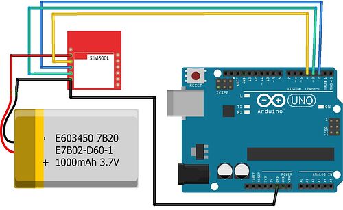

When I connect sim800l module directly on 5v, it works fine and show me result in serial monitor as from picture. But as I told in first post, when I send sms - module start blinking rapidly without sms text on serial monitor. So, after 2 days I get idea what that can be.
AT command "AT+CREG?" show me is module registered on network. I started typeing command every second while sending sms from phone with second hand. And voila! Module lost connection/network every time when it need to receive sms...
I have LM 317 and trying with it to change voltage, but in that case module won't get network...
I am pretty sure now code is OK. Trying to find out how to fix this issue.
I sounds like you have a power issue.
The LM317 may need be able to supply 2A the tutorial says is needed during some transmission bursts, buts not clear what is actually required to receive an sms and not drop from the network due to low power. I have seen reference on the internet to some modules dropping off the network if the voltage drops below 4.0.
The operating voltage of the chip is from 3.4V to 4.4V. Connecting to 5v is a bad idea.
Can you provide details of the module you actually have, and how it is being powered?
It works!
I find some battery from old phone (BL-5CT 1050mAh 3.7V), and I wired it as on the picture:
Just without reset pin, and it WORKS!
Thank you!
