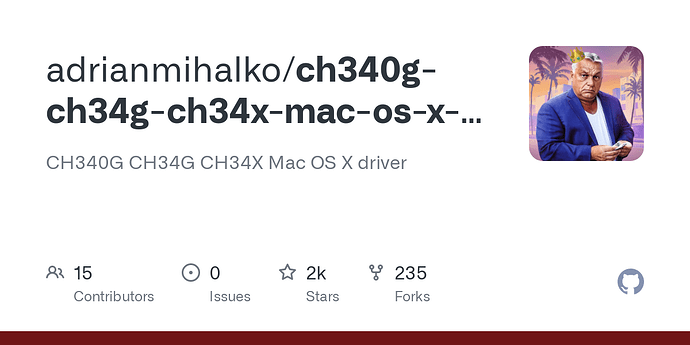

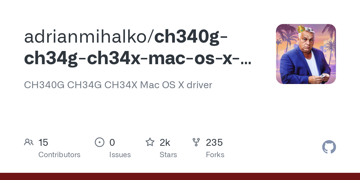

After that you might install the latest CH340 driver which is promoted as being "Sierra compatible": https://github.com/adrianmihalko/ch340g-ch34g-ch34x-mac-os-x-driver

now it works for me by follow all of the steps here https://github.com/adrianmihalko/ch340g-ch34g-ch34x-mac-os-x-driver
