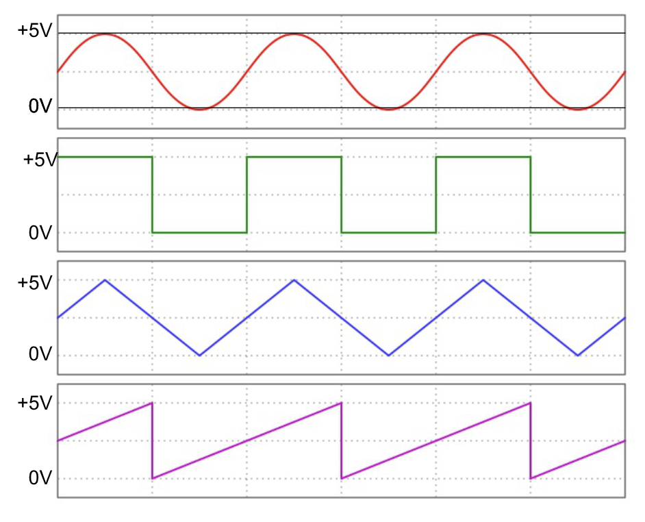

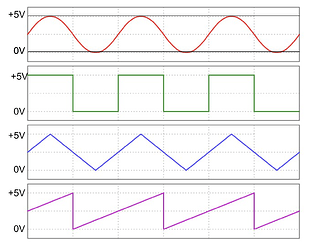

There seem to be two interpretations of what you are looking for:
  1. a circuit that takes as an input any waveforms like these
    and converts them to waveforms like these
    which would require an op amp and dual power supplies.
or 2) something that just operates on a simple on/off signal like the green waveform and shifts its level to +/- 5V.
Can you say which?
This is a bit tricky for me to answer because those waveforms to me are the shapes one would get out out an oscillator for musical application, but I know that the Arduino has a PWM so there are non-musical applications, and I'm probably going to confuse things here.
In Pure Data, the software I'll be using on my laptop, I will be able to for example:
  • send a fixed 'on' signal of a specific voltage that could tune an oscillator to a specified pitch for a drone
  • automate the above signal to modulate around the specific voltage by a fraction of a voltage to detune the pitch very slightly to add a bit of warble character movement
  • create on/off pulses like a square wave to function as a metronome
  • automate a slider to move from -5v through 0v to +5v and back in a loop over a specified time (creating a sort of low frequency oscillator)
  • assign voltages to the keys of a midi keyboard controller, sending a specified voltage for each key I play
Technically I'm not sending voltages from the software of course, I'm sending numbers through the serial port to Arduino, which then sends them to the DACs, but in the software I can program a patch so that everything works in a -5 to +5 range so I'm thinking in voltage.
So, from my very uneducated perspective it sounds like your second interpretation, in that I will send intentionally chosen specific voltages, within the +/- 5V range, from Arduino to my synth. Except that it is not a simple on/off signal, it can go up and down like and LFO, or jump around eccentrically within that voltage range.
The synth reads the voltage and what it does with it depends on the function of the synth module, e.g. turns on an actual saw wave oscillator that I can sequence.
I hope that makes sense, I'm learning on this forum that I'm quite bad at explaining myself!
I think from your explanation that the opamp with dual polarity power supplies is the solution then.

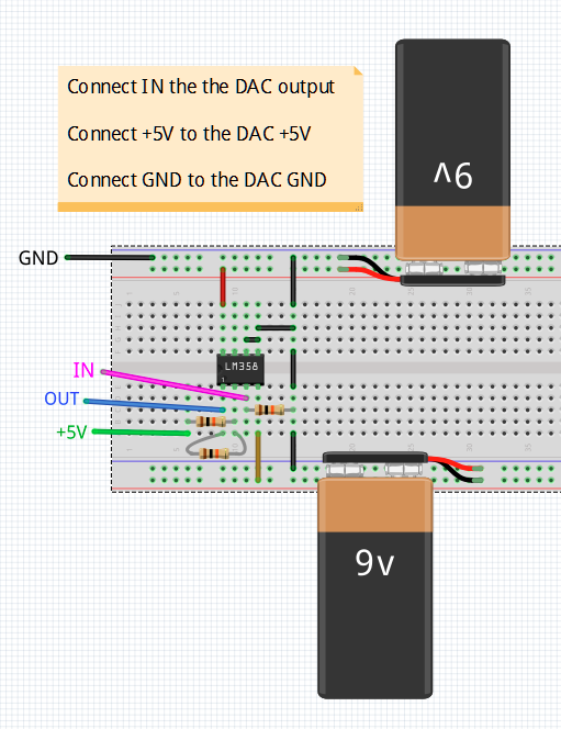

Since you are new to all of this, I suggest you experiment with this circuit. It uses a very common and inexpensive LM358 op-amp and two 9V batteries. After you have tried it, you can move on to a +/- supply.

This is the schematic diagram for the picture diagram in Post #46 for when you get to the point where you want to modify or add to the circuit or just figure out how it works.
Update: Add 5V precision reference for 5V.
@jim-p
Maybe I shouldn’t wake the bear, but: OP works from his laptop. The circuit is indeed simple. But: the output is referenced to the +5V, which comes from USB. When the USB voltage drops from 5.25V to 4.75V what happens to the opamp output? (The DAC isn’t bothered, internal reference, output referenced to GND.)
Could add a 5V shunt reference to the circuit.
This 5V reference needs to be powered from the battery, not from USB (that might be 4.75V).
Yeah, sorry, I should have mentioned that I added it to the circuit in post #48.

Thank you @jim-p for the breadboard illustration, that's really clear for me as a beginner. Thanks @EmilyJane for the schematic also. Thanks everyone else who has chipped-in so far too. I'm going to order LM358 and the other bits I need to have a go at making that, and pick apart the circuit to to learn about what is going on.
If I can get that working I'll then see about how to power it via a ribbon cable from my rack.
