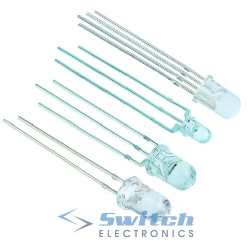

There are several types of bi-color LEDs, requiring different wiring, so post a link to the product page for the one you have.
Here you can just remove the analogRead and slip in your own setting as a constant.
     sensitivity = 512;    // set the sensitivity to 1/2
sensitivity cou,d range from 0 to 1023 if you had the pot in there, so use numbers in that range as you test.
Or. You could come to a better understanding of the roll of sensitivity and just code that area differently.
HTH
a7
these are the ones I ordered in red/green 5mm
thanks A7 I'll give that a go then change the value as needed
Bit of an update I have stripped the code right back to just one pezo and 1 led and taken out the random mode.
I have managed to get the led to light green when the target is hit but it will not light red when not being triggered any ideas?

What's the difference? A bi-colour led can display red, green or yellow, so you could call that an "RGY" led. How are the "RGY" LEDs that the code was written for different to the LEDs you want to use now?
The rgy led have 4 leads where as the bi-colour i have are only 2
Never heard of those before. Why would anyone make an led with red, green any yellow chips in it? You can so easily make yellow by illuminating red and green together!
Do you ever want the led to light yellow?
If not, I would suggest not using that library. I think it is confusing you.
Try
  led.setColor(1);  // red
  led.setColor(2); // green
For a 2 pin bi-color led, i actually use just simply a voltage divider between 5v & GND (220R & 330R but the values may vary a tad depending on the LED and which leg you connect) and connect one pin(leg) of the LED halfway between the 2 resistors. Connect the other leg to The IO pin of the arduino.
Setting the pin 'HIGH' will light up 1 color, setting it 'LOW' will light up the other color, and setting the pinMode to INPUT will turn the LED off.
Thanks i dont need yellow so will give that a go
That bicolor LED has only two leads, so to get each color you have to reverse the direction of current flow. Does the library do that?
Yes, I reviewed the library code (there's not much of it). If you want yellow, you need to call it's .drive() method frequently (i.e. no use of delay()) and it will reverse the current flow each time.
