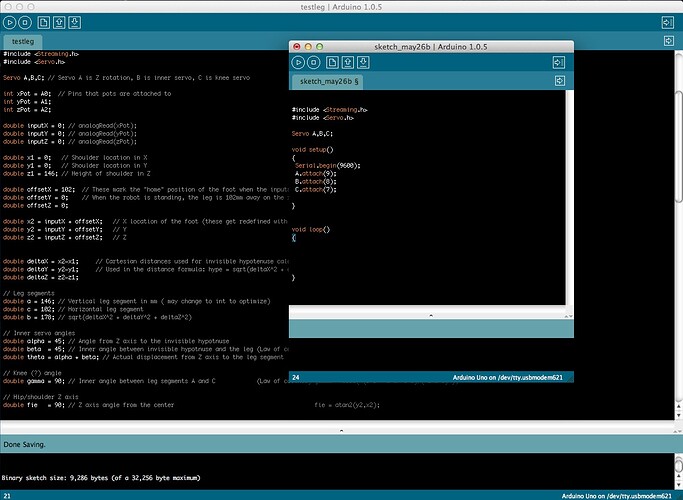

Hello all, I have pretty bad eye sight and bright white backgrounds are painful to my eyes. I have been toying with the themes.txt within the Arduino 1.0.5 Application (on Mac, find Arduino App icon, right click -> show package contents -> contents -> resources -> java -> lib -> theme)
So far I was able to "downgrade" back to the Arduino 00xx deep greenblue scheme and change my back ground to be black on white. However, I cannot figure out how to make the white scroll bar and white bar in between the console and text editor to be black. Is this OS specific? And is there a way to make the cursor white? I am trying to get the final touches in. So far the darker colors are much easier on my eyes. For those interested, I pretty much just copy and pasted the 0023 theme to my 1.0.5 themes folder and manually copied the contents of themes.txt to make sure everything was where it should be.

I think I have found a combination that works well
This changes the background and foreground to white text with black background
foreground and background colors
editor.fgcolor = #ffffff
editor.bgcolor = #000000
This makes the cursor blue and easier to see with a black background
caret blinking and caret color
editor.caret.color = #85e6fc
This makes the highlighting baby blue which is a little easier
selection color
editor.selection.color = #6e8ced
Hopefully this helps someone out there!
