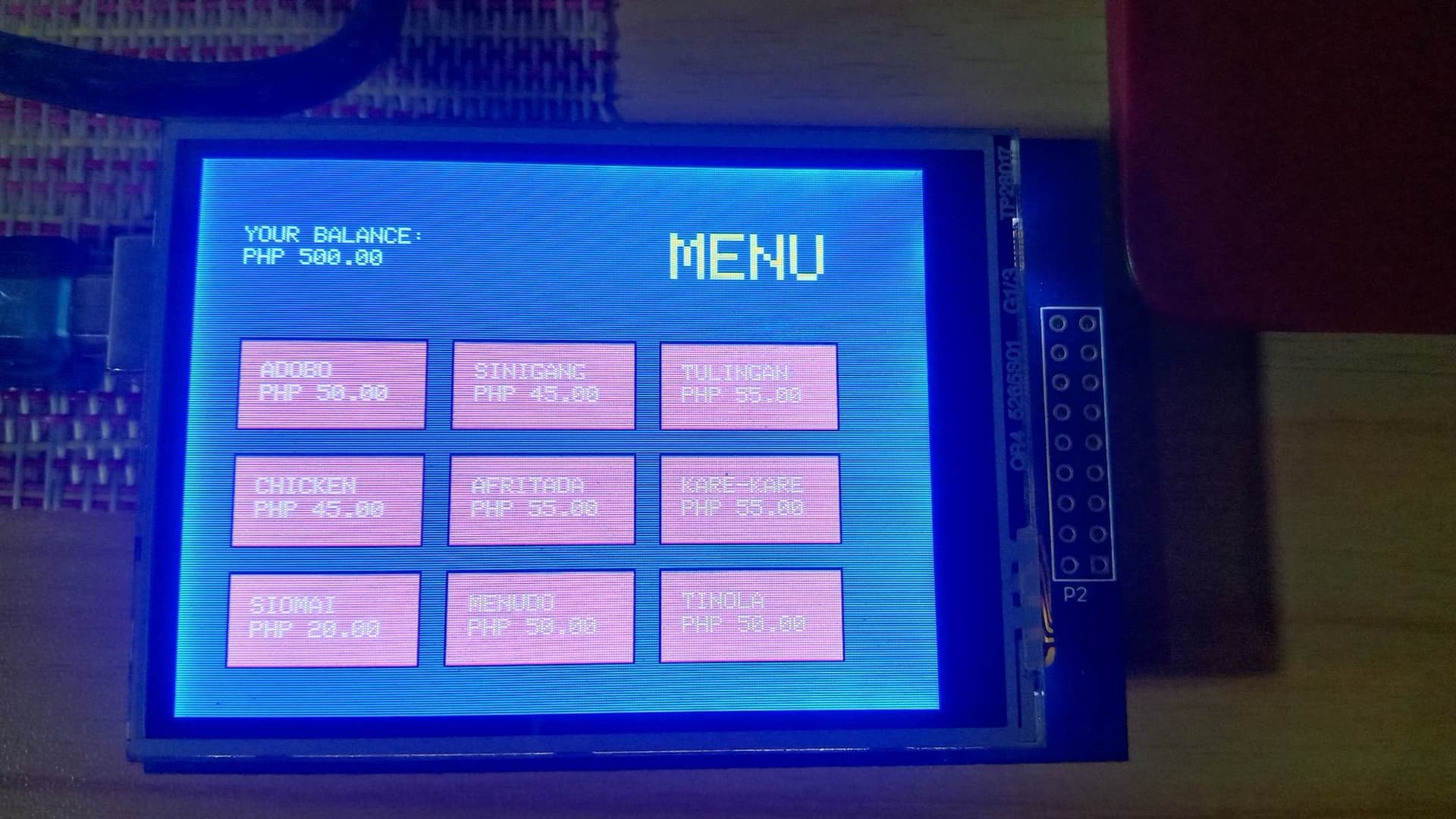

I've been working on a canteen ordering through Arduino and TFT Touch Screen module. One of the features that I plan to achieve is having the balance (as seen at the feature) decrease as a user press a button, which denotes a dish and it's price (which will be deducted to the balance). How can I achieve it? Is it possible to do it with "math.h" library?
Here is the interface of my TFT:
While here is the code:

That looks like where you could place a variable to display a balance instead of a constant 500.00.
You don't need any library to add numbers up.
Add new costs to a variable called balance or whatever. Subtract the cost of any cancelled item.
a7
Can you give an example using the code? Thank you in advance.
You need to add a balance variable before void setup().
int balance = 0;
Then, for every button pressed (for example ADOBO: 50.00) subtract that amount from BALANCE

And then you need to update balance:
  tft.setCursor(20,40);
  tft.setTextColor(WHITE);
  tft.setTextSize(1);
  tft.print(balance);
  // tft.print("PHP 500.00"); // do not hard-code the balance

I applied it to my code, and somehow it didn't deduct to the positive balance, what could be the problem?
See post #6 @alto777 ... you need:
  1. Create a starting balance.
  2. Deduct price of choice from balance
  3. Display balance.
Show each step by showing your full sketch.
So far I did all of the steps, but the balance still didn't subtract on the TFT screen

  tft.begin(identifier);
  tft.setRotation(1);
  tft.fillScreen(BLUE);
  tft.setCursor(205,30);
  tft.setTextColor(YELLOW);
  tft.setTextSize(3);
  tft.print("MENU");
  tft.setTextSize(1);
  tft.print(balance);
  tft.setCursor(20,30);
  tft.setTextSize(1);
  tft.print("YOUR BALANCE: ");
  // dishOne
  tft.fillRect(20,80, 80, 40, MAGENTA);
  tft.drawRect(20,80,80,40,BLACK);
  tft.setCursor(30,90);
  tft.setTextSize(1);
  tft.print("ADOBO");
  tft.setCursor(30,100);
  tft.setTextSize(1);
  tft.print("PHP 50.00");
  // dishTwo
  tft.fillRect(110,80, 80, 40, MAGENTA);
  tft.drawRect(110,80,80,40,BLACK);
  tft.setCursor(120,90);
  tft.setTextSize(1);
  tft.print("SINIGANG");
  tft.setCursor(120,100);
  tft.setTextSize(1);
  tft.print("PHP 45.00");
  // dishThree
  tft.fillRect(200,80, 80, 40, MAGENTA);
  tft.drawRect(200,80,80,40,BLACK);
  tft.setCursor(210,90);
  tft.setTextSize(1);
  tft.print("TULINGAN");
  tft.setCursor(210,100);
  tft.setTextSize(1);
  tft.print("PHP 55.00");
  // dishSeven
  tft.fillRect(20,180, 80, 40, MAGENTA);
  tft.drawRect(20,180,80,40,BLACK);
  tft.setCursor(30,190);
  tft.setTextSize(1);
  tft.print("SIOMAI");
  tft.setCursor(30,200);
  tft.setTextSize(1);
  tft.print("PHP 20.00");
  // dishEight
  tft.fillRect(110,180, 80, 40, MAGENTA);
  tft.drawRect(110,180,80,40,BLACK);
  tft.setCursor(120,190);
  tft.setTextSize(1);
  tft.print("MENUDO");
  tft.setCursor(120,200);
  tft.setTextSize(1);
  // dishNine
  tft.fillRect(200,180, 80, 40, MAGENTA);
  tft.drawRect(200,180,80,40,BLACK);
  tft.setCursor(210,190);
  tft.setTextSize(1);
  tft.print("TINOLA");
  tft.setCursor(210,200);
  tft.setTextSize(1);
  // dishFour
  tft.fillRect(20,130, 80, 40, MAGENTA);
  tft.drawRect(20,130,80,40,BLACK);
  tft.setCursor(30,140);
  tft.setTextSize(1);
  tft.print("CHICKEN");
  tft.setCursor(30,150);
  tft.setTextSize(1);
  // dishFive
  tft.fillRect(110,130, 80, 40, MAGENTA);
  tft.drawRect(110,130,80,40,BLACK);
  tft.setCursor(120,140);
  tft.setTextSize(1);
  tft.print("AFRITADA");
  tft.setCursor(120,150);
  tft.setTextSize(1);
  // dishSix
  tft.fillRect(200,130, 80, 40, MAGENTA);
  tft.drawRect(200,130,80,40,BLACK);
  tft.setCursor(210,140);
  tft.setTextSize(1);
  tft.print("KARE-KARE");
  tft.setCursor(210,150);
  tft.setTextSize(1);
  TSPoint p = ts.getPoint();
  if (p.z > ts.pressureThreshhold)
   p.x = map(p.x, TS_MAXX, TS_MINX, 0, 320);
   p.y = map(p.y, TS_MAXY, TS_MINY, 0, 480);
   if(p.x > 20 && p.x < 60 && p.y > 80 && p.y < 160 && buttonEnabled)
    buttonEnabled = false;
    pinMode(XM, OUTPUT);
    pinMode(YP, OUTPUT);
    dishNine(); // draw the ninth dish
   if(p.x > 110 && p.x < 150 && p.y > 80 && p.y < 160 && buttonEnabled)
    dishSix(); // draw the sixth dish
    if(p.x > 200 && p.x < 240 && p.y > 80 && p.y < 160 && buttonEnabled)
    dishThree(); // draw the third dish
   if(p.x > 20 && p.x < 60 && p.y > 180 && p.y < 280 && buttonEnabled)
    dishEight(); // draw the eight dish
   if(p.x > 110 && p.x < 150 && p.y > 180 && p.y < 280 && buttonEnabled)
    dishFive(); // draw the fifth dish
   if(p.x > 200 && p.x < 240 && p.y > 180 && p.y < 280 && buttonEnabled)
    dishTwo(); // draw the second dish
   if(p.x > 20 && p.x < 60 && p.y > 300 && p.y < 460 && buttonEnabled)
    dishSeven(); // draw the seventh dish
   if(p.x > 110 && p.x < 150 && p.y > 300 && p.y < 460 && buttonEnabled)
    dishFour(); // draw the fourth dish
   if(p.x > 200 && p.x < 240 && p.y > 300 && p.y < 460 && buttonEnabled)
    dishOne(); // draw the first dish
void landingPage() {
  tft.setCursor(40,30);
  tft.setTextSize(2);
  tft.print("Your order has been");
  tft.setCursor(100,50);
  tft.setTextSize(2);
  tft.print("received.");
  tft.setCursor(20,100);
  tft.setTextSize(2);
  tft.print("If you made a mistake,");
  tft.setCursor(50,120);
  tft.setTextSize(2);
  tft.print("please inform us");
  tft.setCursor(80,140);
  tft.setTextSize(2);
  tft.print("immediately.");
  tft.setCursor(60,200);
  tft.setTextSize(1);
  tft.print("(C) 2023 CALAMBA CITY SCIENCE");
  tft.setCursor(90,210);
  tft.setTextSize(1);
  tft.print("INTEGRATED SCHOOL");
void dishNine() {
  Serial.print("TINOLA  ");
  Serial.print("\t");
  Serial.println("Php 50.00"); // cost
  balance = balance - 50; //subtract the cost from the balance
  landingPage();
void dishSix() {
  Serial.print("KARE-KARE");
  Serial.print("\t");
  Serial.println("Php 55.00"); // cost
  balance = balance - 55; //subtract the cost from the balance
  landingPage();
void dishThree() {
  Serial.print("TULINGAN");
  Serial.print("\t");
  landingPage();
void dishEight() {
  Serial.print("MENUDO  ");
  Serial.print("\t");
  landingPage();
void dishFive() {
  Serial.print("AFRITADA");
  Serial.print("\t");
  landingPage();
void dishTwo() {
  Serial.print("SINIGANG");
  Serial.print("\t");
  Serial.println("Php 45.00"); // cost
  balance = balance - 45; //subtract the cost from the balance
  landingPage();
void dishSeven() {
  Serial.print("SIOMAI  ");
  Serial.print("\t");
  Serial.println("Php 20.00"); // cost
  balance = balance - 20; //subtract the cost from the balance
  landingPage();
void dishFour() {
  Serial.print("CHICKEN  ");
  Serial.print("\t");
  landingPage();
void dishOne() {
  Serial.print("ADOBO  ");
  Serial.print("\t");
  landingPage();
Very good. You can see that the following is in void setup() which prints your balance at the start, but you need to have it in void loop() to update all the time.
