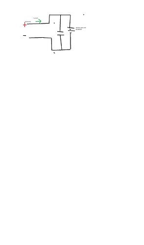

hi all! i need some help/advice with a project that i am doing. essentially, i am building a simple wind generator using a PC DC motor. Using a multi meter, i was able to measure the current generated.
lets say i want to charge a 5v battery pack, can i just plug the two wires from the generator into the battery terminals? i know i need a charge protection circuit, thats why i am using a battery pack, as i know there are protection circuit built into it.
i have uploaded a picture, i am sure there are errors, but thats the rough schematic that i can think of. how can i regulate the output output of the generator so that i can charge the battery?
Also, is it possible to charge the battery pack without a constant voltage/current ? any suggestions in modification is greatly accepted =) basically i just want to charge a battery pack using the PC fan as a generator thanks =_)

If you just connect the generator and battery together as you have drawn it, what you have is essentially an electric fan.
I don't know what sort of battery you're looking at that has internal protection, but the fact that it needs it is enough to suggest that this is not a battery that you should be taking liberties with. You will certainly need a charger between the generator and the battery - what sort of charger you need would depend on the battery type.
The voltage output by your generator will vary hugely depending on the wind speed. In order to avoid wasting energy when the voltage is not what the battery requires to be charged, you could use a boost/buck converter.
haha thats true, didnt see that, probably should insert a diode there will the solar lawn light circuit work for charging a battery?

That looks like an adequate LiPo charger but as far as I can see it assumes a regulated 5V supply. You would need an external buck/boost converter to convert the variable output from your generator to 5V.

I'd suggest using a mosfet between the windmill and battery (control current to the battery) and some type of sensor to detect the rotation speed of the windmill. When you sense that the windmill is spinning at a good pace just switch the mosfet on to start charging the battery. Eventually you'll want to tune it so you're switching the mosfet on and off frequently to keep the windmill turning at a stable speed.

hi all, thanks for the reply, i remeasured the output by blowing into the blades, and produced roughly 2v and 30 mA at max speed. can a buck converter boost that voltage? if i can use a 5v voltage regulator, would it work?

i agree haha, but this stage is just a prototype, i want to make sure i know that the circuit works before is start investing in something bigger. i came across the schematic for the garden solar board, and apparently, all i need is a shotcky diode if i replace the solar cell with a generator
http://www.instructables.com/id/Simple-solar-garden-lamp-circuit/
is it possible? wont i have to worry about overcharge?

You need an efficient boost/buck converter with a low quiescent current.
A cheap one from e-bay this one is about 18mA which is a good percentage of what you'll be generating.

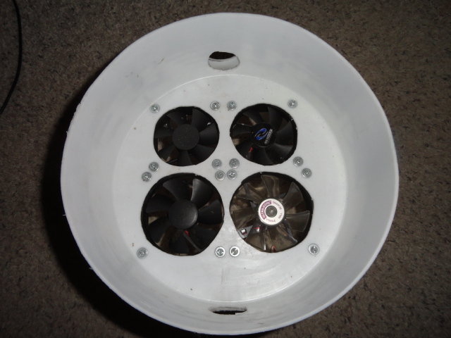

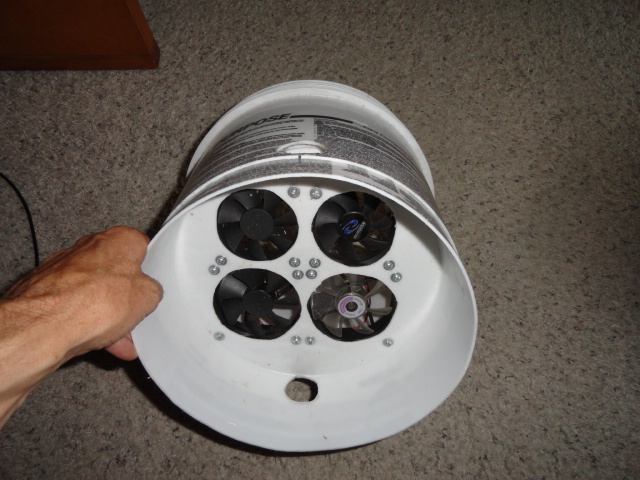

I made a turbine using 4 x PC fans, in a decent wind it would generate enough power to run 1 x PC fan at a little more than half speed. Not very efficient but it worked. Much better at charging 2 x AA batteries, then using a joule thief to power a 1W LED.
Used a 5 gallon bucket for the head, rope tied to top hole and a tree branch, another rope tied to bottom hole and a concrete block on the ground.

A buck converter can never get 5V from less than 5V input.
Did you mean a boost converter? Beware, as those only work as intended if your supply can deliver at least as much power IV as demanded. The micro oscillator in the garden lamp circuit might be more reasonably sized to what you are doing.
