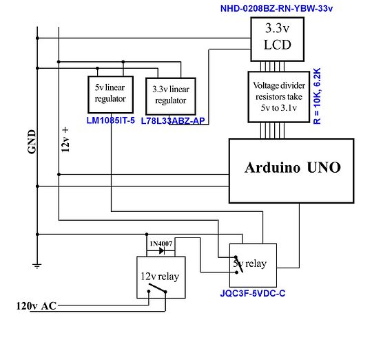

I am getting "noise" from a 12V DC relay, even though I have a snubber diode across the coil (see circuit diagram). The 5v relay has an optocoupler. My test code simply activates/deactivates the 5v relay and posts the value of the function millis() to the LCD. If the 12v relay is not energized (disconnect the GND) the LCD functions normally, even when the 5v relay is cycled. With the 12v relay enabled, however, the LCD text is garbled most of the time. This happens whether or not the 120v is connected to the contacts.
I scrounged up a different 12v relay -- its contacts are rated at 10A, as opposed to the 30A for the problematic relay -- and had no interference.
The 30A relay draws about 230 mA when it is activated. The 12v power supply is rated at 2A, and the 5v linear regulator is rated at 3A. Using a DMM to check, I could not see any voltage drop when the relays were activated so I am thinking the problem isn't just a lack of energy.
Could the cheap 12v relay be causing that much noise? I have no spec sheet on it -- I bought the relays on eBay and they have no documentation whatsoever, other than a graphic showing pin functions, and the notation that it's a 12v relay.
I have ordered some 12v relays with built-in diodes and hope the problem goes away. On the other hand, I'm not sure how the cheap relay could be causing the problem. I checked the diode with my DMM and it appears to be functional -- voltage drop and resistance are the same as the values for the other identical diodes I have not used. Also, the diode is soldered into the quick connect terminals that supply (+) and (-), so it is used when I connect either of the 12v relays.
Any thoughts?

Describe the 5V linear regulator. Post an image of the project.
Which you're not using. Because you have a single supply with shared ground.
Why the 3.3volt regulator. An Uno has a 3.3volt/150mA regulator build-in.
Give us links to the parts you're using.

Here is an updated image with parts identified. Is the 3.3v regulator possibly causing the problem? How should the 5v relay be connected in order to benefit from the optocoupler?

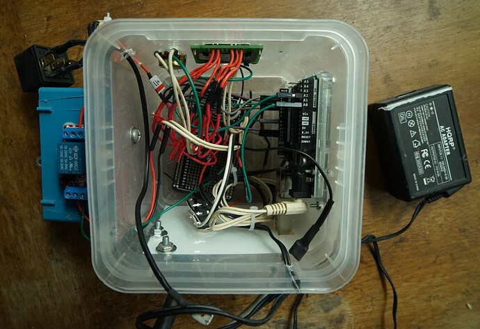

will you please post an image of the project. The 'schematic' from post#5 is lacking in details that may be gleaned from looking at a project image.

Sure, here's an image. I didn't know that using a higher voltage input was very inefficient -- what are the drawbacks?

The 5V relay looks like it is just a coil and not an opto driven or silicon driven module. The Uno's GPIO pins have a current limit of how many amps? How many amps does the 5V relay want?

How is anyone going to determine the correct wiring diagram from a misrepresentation?

That is what I understood -- don't attempt to sink more than 40mA from one of the digital pins. The relay I am using draws 5 mA. The power for the coils comes from the 5v regulator. Did I draw that correctly?
If I understand you correctly, that is the arrangement on the 5v relay -- it uses a 5mA signal from the Arduino to activate the coil, but the power for the coil comes from the regulator (as per my diagram).
