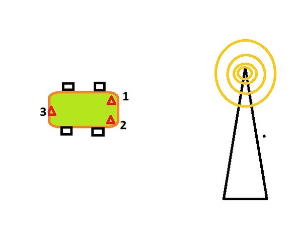

I have an idea and would like to know if the reasoning is sound
What I want
I have a “arduino controlled 4wd car” and a signal being emitted by another arduino (tower from now on) somewhere in the house.
I want to make the car able to go toward the tower in a straight line (the car can detect obstacles, so it would eventually get to the signal).
To do that, the car must detect the signal and know what direction to go.
My idea (that I took from owls) to that.
Tower emitting signal. 3 receivers (Rx from now on) on the car (red triangles). The receivers are synced. Car is around 250mm*180mm
If I know that Rx 1 received the signal at 1.5 mili seconds, Rx 2 in 1.6 mili, and Rx 3 in 1.0 mili.
I also know that I need to turn the slightest bit to the left AND that I need to turn 180 degrees, since Rx3 should be the last to receive the signal.
One easy way to do that, would be measuring response time. But that is a no go. As self-imposed condition (at least for now), i don’t want communication between tower and Rxs. Tower is pure Tx and Rxs are pure Rx.
With no communication, my idea is the following.
Tower will emit a changing signal.
1, 2, 3, 4, 5, 6, etc…
At a fixed point in the timeline each Rx will receive a different signal
Ex: at instant 3 in the timeline,
Rx1 received 2
Rx2 received 3
Rx3 received 7
In this case, since i know the order and the time between different messages, with some math I can find out what maneuver the car has to make to align itself with the signal in a straight line.

What type of signal? If a radio signal, the scheme, as I understand it, won't work at all. Radio waves travel about 1 meter in 3 nanoseconds.
From one room to another in my apartment, the signal takes around 1 milisecond from tower to Rx
That sounds like radio, and you are confusing the time it takes for the message to be processed by the receiver, with the time it takes the signal to travel from one point to another (see above).
I don't think owls can hear RF
for response time, i used the nrf24. Why would radio not work (wavelength?)?
i would use the signal necessary to make it work
Speed. See reply #1 (edited).
To elaborate, radio can be made to work by using advanced technology, such as ultra wide band radio. Pozyx is such a system, and took years to develop. It is not cheap.
Pozyx fails in situations where reflections confuse the receiver, so Pozyx also includes motion processing sensors and MPUs to keep track of position in those circumstances.
In principle your idea could be made to work with sound, which travels at a speed that an Arduino can easily deal with. Lots of people have tried, with varying degrees of success.
One option is to have three fixed light beacons (like lighthouses for ships) and have a light detector on the car that can be rotated and which can identify the angle at which it sees each light.

if you are looking to create a directional signal, so that you know what direction the lighthouse is from the current location, then maybe, some directional antennas would get you to the room with the lighthouse.
had not thought of directional antennas.
dont really know anything about them so ill research a little.
do you know how big/small of a angle/cone the see?
mounting the antenna (maybe 3???) on rotating plataforms might do the trick
edit
wait wait wait
maybe i dont even need direction antennas if a make a lighthouse in the robot
an actual lighthouse. BUT INVERTED
i put a rotating cover on the nrf. we a very small opening. this cover would me made of ???? in order to blind it. when i do get a signal, it means the cover is facing the tower. than i just ajust the robot accordingly

Psuedo-doppler direction finding works by rapidly switching between several antennas. The difference in the time that the signal arrives at each antenna can be used to calculate the transmitter's direction.
https://www.rtl-sdr.com/building-an-rf-direction-finding-robot-with-an-rtl-sdr/
Old 27mhz rc transmitters and receivers have good penetration and not so much else on that frequency I think
