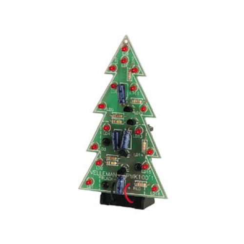

I'm new in the Arduino's World and I'd want to create a Christmas Tree like that in the figure and I wrote the program, but I don't think it is good.
I'd want also put a botton before the circuit that every "touch" I'll put to the Button it will be change the function of the Christmas Tree.
So:
First Touch:
All the Leds Light On and a second later Light Off.
Second Touch:
The Leds Turn On one by one e Turn Off one by one.
Third Touch:
Some Leds Light On and after Light On the other Leds.
Some Leds Light Off and after Light Off the other Leds.
Fourth Touch:
The Leds Light On and Light Off sequentially.
I put the program I wrote and the image of a similar Christmas Tree in "Attachments".
Help me please to finish this project. I'd want to give as a present.
If someone speaks Italian it'd be fantastic!!!
Thanks so much!!!

Make life a bit cleaner by using more compact code:
Make functions AFTER the void loop() for the different things you want to do. Here is a function for turning all LEDs on and then another function for turning them all off after x time.
  //calls the function. Make a list of your custom functions in here.
  all_on_all_off(5);
//A Function to turn all on....delay (x) seconds and then turn all LEDs off
void all_on_all_off(int x) {
  for (byte i = 2; i < 13; i++) {
    digitalWrite(i, HIGH);
  delay(x * 1000);
    digitalWrite(i, LOW);
I was bored so I will give you a head start by removing all the delays in your code.
just redesign the loop code to read a button and advance rather than letting the state advance on its own (remove the timer in the loop also as it replacing large delays in your original code)
got bored naming things so im sure you can use edit-find word and replace with better names
