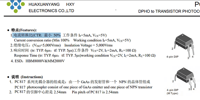

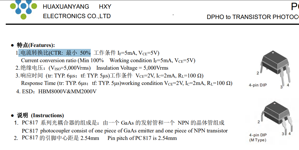

Kmin datasheet said in worst case CTR ratio is 50% minimum guaranteed CTR is 50% which they tested at 5V .CTR can be more than 50% but we should consider 50% in designing purpose

So what would be the point of different models A...D?

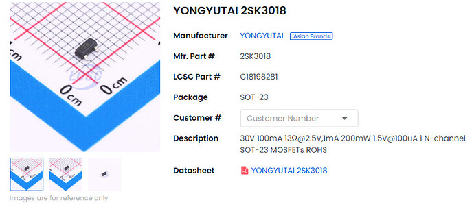

what about this mosfet
This is a much simpler and cheaper solution:
It's just about acceptable, but if possible, choose one with a VDS of at least 40V

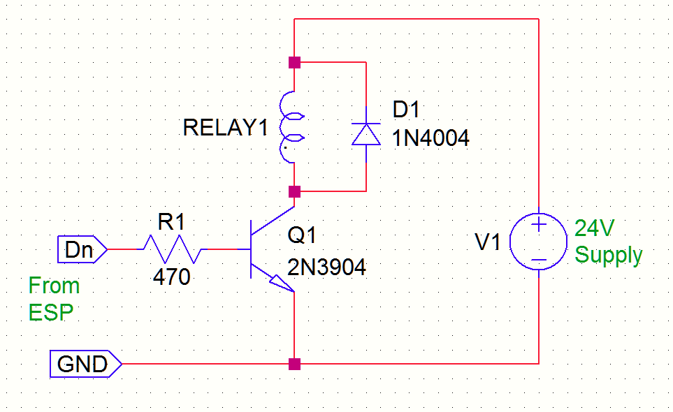

If that's not the point here, common relay modules use transistor, often together with optocoupler. No need to reinvent a wheel...
Also much simpler, one 4 pin DIP and one resistor:

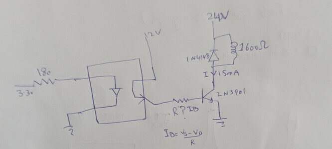

If I go with this circuit, please tell me how to select the resistor value at the base of the transistor.
I am trying to find out, but I don't seem to be correct.
Which optoisolator are you using?
pc817C
You need to use a smaller current like 10mA
So (12-0.7-0.2)/0.010 = 1110.
1.0K ohms would be good
The 0.2V is the optoisolator saturation voltage.
Why not use the circuit I show in post #33
+1
As in post#10.
OP is over-thinking things with the opto coupler.
Leo..
AQY282eh costs $2.80, while its alternative SUPSiC GAQY212GH is $0.81. Both prices are expensive compared to PC817 at $0.029 and 2N3904S at $0.01. Adding four circuits to a board significantly increases the cost.
Uh, right, sorry, my mistake, I missed that last curl... :wink:
You did not mention cost before.
If there is no reason to isolate the 24V then use the circuit in post #29, it's the cheapest.
