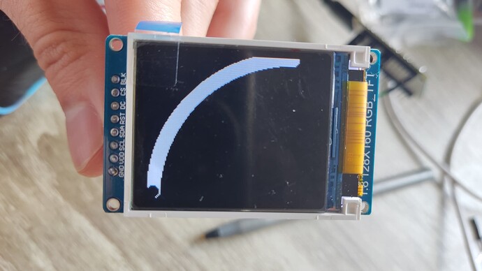

I'm trying to write a code for simple progress bar (0-90 degrees) that uses tft.fillCircle
Basically a circle that sweeps from 0-90.
I have used a math formula for calculating the X,Y of the center of circle.
-That part works ( it sweeps from 0- to 90)
I'm also using analog input from Potentiometer to test it.
Now what I don't know how to do
How to I connect the ( circles ) to form a line?
How do I avoid flickering I cant use
tft.fillScreen(ST7735_BLACK);
delay(100);
-I cant use that trick ST7735,WHITE,ST7735_BLACK
I think I would need to tft.fillCircle(x,y,r,ST7735BLACK) when the value is dropping
but I cant figure in my head how to write an if loop. The part that compares the value vs previous value is confusing me.
What I get with my code is

what ? which board is it?
It is ESP32
Display is ST7735 (160x128) Adafruit Library st77xx
If I write
int temp=0; /// Variable to store the previous value
temp=u; /// And here I say store current value in temp
Then I compare it (if temp=! u) { to this}
how does the program know that it's storing the previous value and not the current one? in (temp) ?
i am not sure if it work.
my plan is draw sector from 0 to needed angle in white, and erase with black if value go smaller.

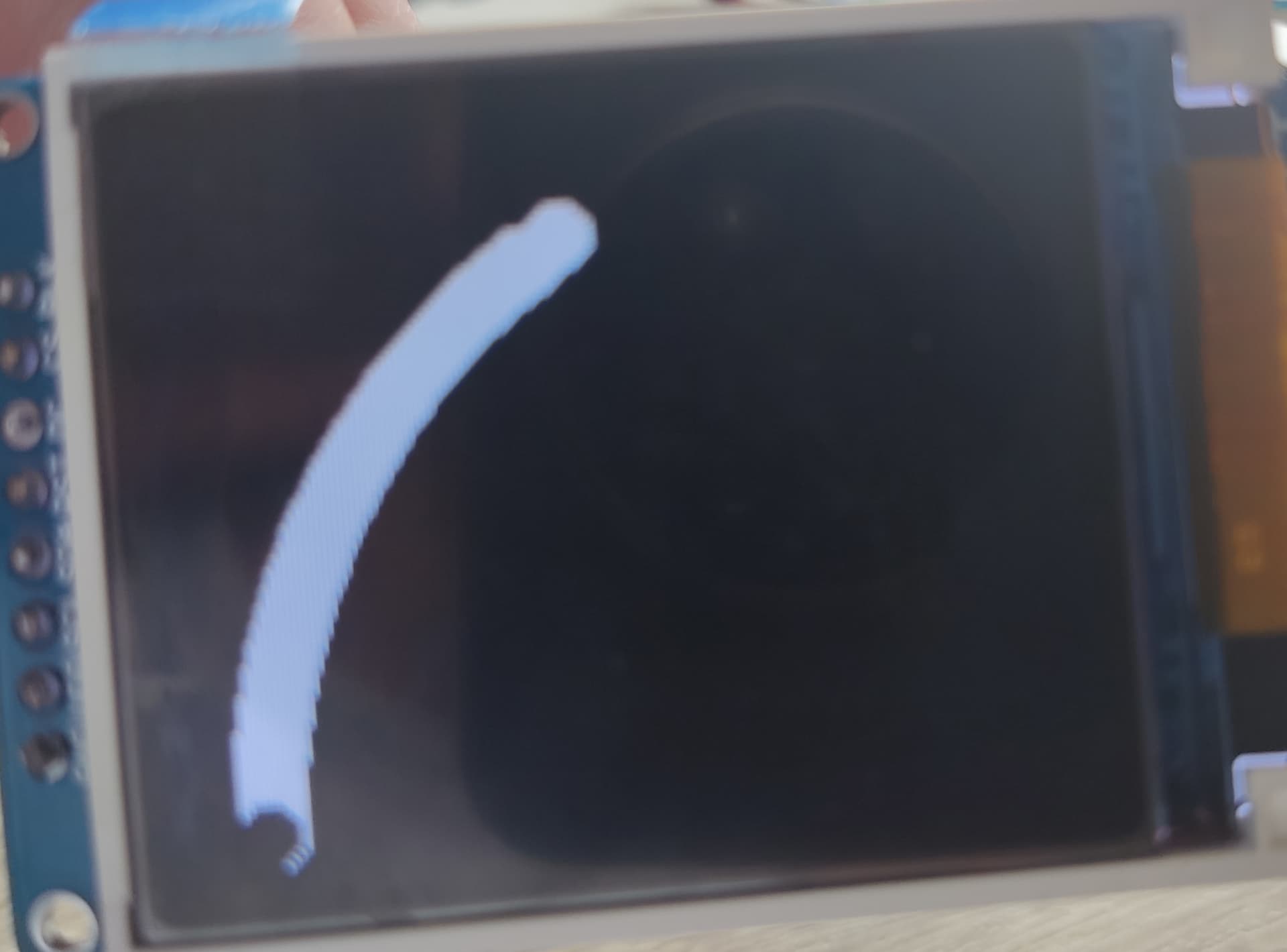

I had to set the r in tft.fillCricle to 5.
r-defined is the length of of arc.

With that code, circles form a progress bar line (0 -90 deg)
When you reduce the input on potentiometer, it doesn't delete the line going from 90 towards 0.
It creates a black circle in 0 degrees ( x,y)
thank you for the core @kolaha
Save the previous temp in a different variable before you read the new one and compare current with previous values to determine whether it has changed
Basically I have to do this to compare the values if (OldPotValue < potValue)tft.fillCircle(x0 - x, y0 - y, 5, ST7735_WHITE); //Draws circle 5-cicrcle radius else tft.fillCircle(x0 - x, y0 - y, 5, ST7735_BLACK);
I think to solve the black dot just reverse calculate the 90 deg for x,y and then that value-Prev value-x0, same for y0 i will try it now

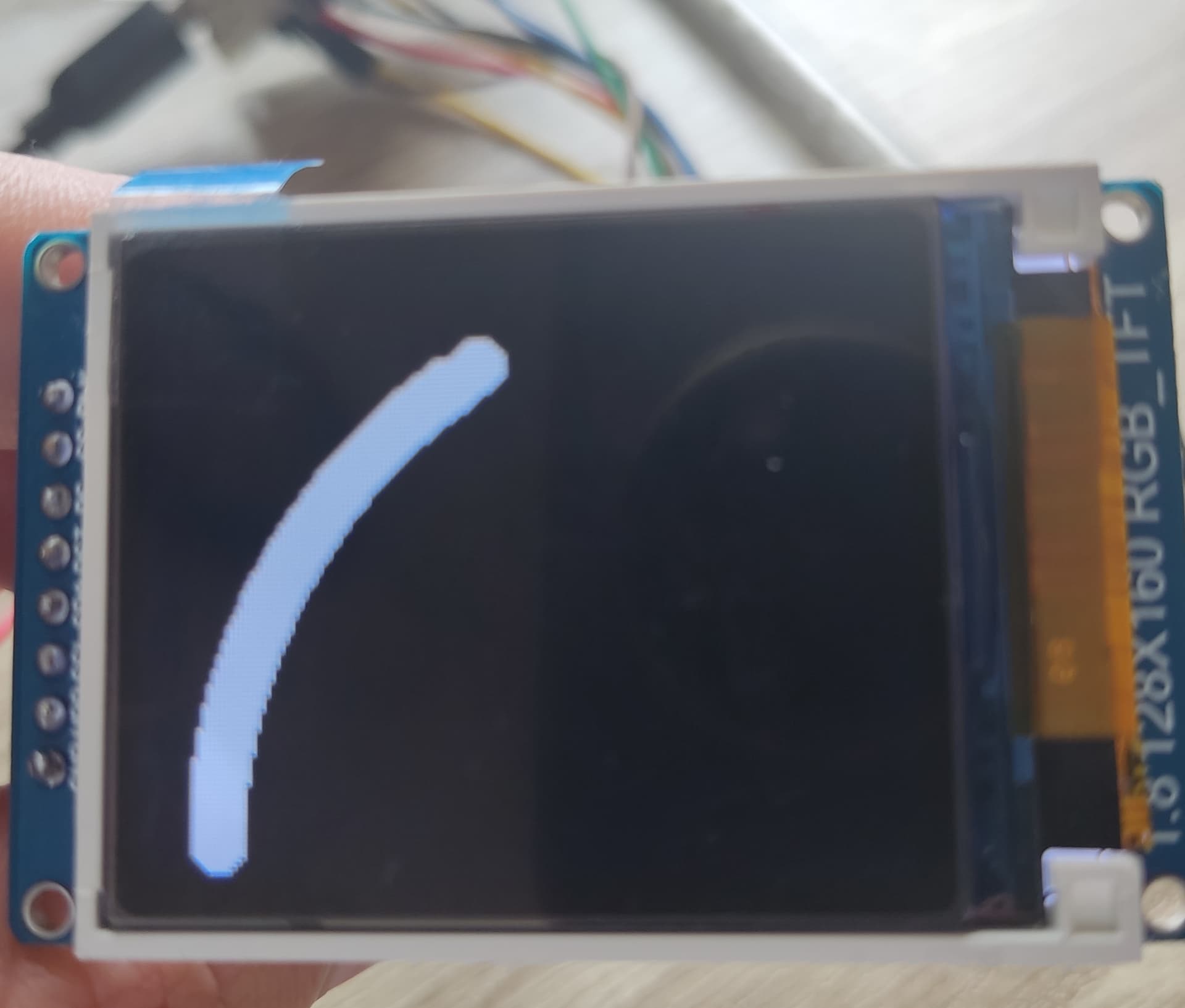

I found this code from user robot
if (val > valOld){//if the bar is longer...add
        //270/sensorMax[0] gives scaling for a 270 degree gauge
        for(angle = ((float)valOld*270/sensorMax[0]); angle <= (((float)val*270/sensorMax[0])); angle+=1){ //the "+=1" can be changed for more "fill in" of the arc (gets noticeable at 5)
        rad = angle * PI / 180;
        tft.fillCircle( (80-((int)(sin(rad)*43.0) ) ), (70+( (int)(cos(rad)*43.0))), 5,barColor);
    if (val < valOld){//if the bar is shorter...erase
      for(angle = (((float)valOld*270/sensorMax[0])); angle >= ((float)val*270/sensorMax[0]); angle-=1){ //the "+=1" can be changed for more "fill in" of the arc (gets noticeable at 5)
      tft.fillCircle( (80-((int)(sin(rad)*43.0) ) ), (70+( (int)(cos(rad)*43.0))), 5,background);
But i don't understand it, I'd like to figure how it works
i see. your code does something different than what you described. Or I didn't understand. Can you sketch/diagram on paper what are you trying to do?
@kolaha
Your code works. (When I turn the potentiometer clockwise 0>3,3v) it draws a white line (0>90 deg) That part works perfect
Example. If the maximum value is 80, and i turn my potentiometer counter clockwise, to 50 degrees, erase the previus max value(80) and display the line @50 degrees
That part works
When i turn the clockwise it deletes in lower left corner and doesnt move any further
It should delete from top towards the bottom left corner
Like progress bar that goes not only 0-100 but also from 100-0 ( this way deleting the previous Max value, if it's replaced by newMax value

When I turn it clockwise - i have to turn it towards the beginning to it to delete the at @0 degrees. Maybe the function is not ok?
   This ESP32 code is created by esp32io.com
   This ESP32 code is released in the public domain
   For more detail (instruction and wiring diagram), visit https://esp32io.com/tutorials/esp32-touch-sensor
#include <SPI.h>
#include <Adafruit_GFX.h>    // Core graphics library
#include <Adafruit_ST7735.h> // Hardware-specific library
#define TFT_CS        5
#define TFT_RST       4 // Or set to -1 and connect to Arduino RESET pin
#define TFT_DC        2
#include "bitmaps.h"
#include "bitmapsLarge.h"
const int potPin = 13; // Analog Pin
int potValue;         // Potentiometer
float Radian = 0;
const int x0 = 130;    // x0 value for cordinate beggining relocation
const int y0 = 120;    // y0 value for cordinate beggining relocation
const int r = 120;     // radius of from x0,y0 to circle (x,y)
Adafruit_ST7735 tft = Adafruit_ST7735(TFT_CS, TFT_DC, TFT_RST);
  // initialize serial communication at 9600 bits per second:
  // initialize the ESP32's pin as aninput
  pinMode(potPin, INPUT);
  tft.initR(INITR_BLACKTAB);
  // Use this initializer if using a 1.8" TFT screen:
  // tft.initR(INITR_BLACKTAB);      // Init ST7735S chip, black tab
  tft.setRotation(1); // set display orientation
  static int x = 0;         // x value
  static int y = 0;         // y value
  static int OldPotValue = 0;
  potValue = analogRead(potPin); /// input signal for potentiometer
  Radian = (float)potValue / 2608.9172;    // Angle 1.57 rad = 90 deg = 4096 analog units
  x = r * cos(Radian);              // Calculation of x of circle
  y = r * sin(Radian);              // Calculation of y of circle
  else {
    tft.fillCircle(x0 - r * cos(Radian + 0.017), y0 - r * sin(Radian + 0.017), 8, ST7735_BLACK);
  OldPotValue = potValue;
@kolaha
Thank you, this one woorks its not smooth ( maybe the potentiometer is sensitive, but its the way it is. I tried setting delay 10, 15 and its a bit better but it still leaves some marks behind.
Here is how it looks with no delay
EDIT: I think to reduce the flickering I need a noise filter on my potentiometer, I've tried running average it helps a bit.
