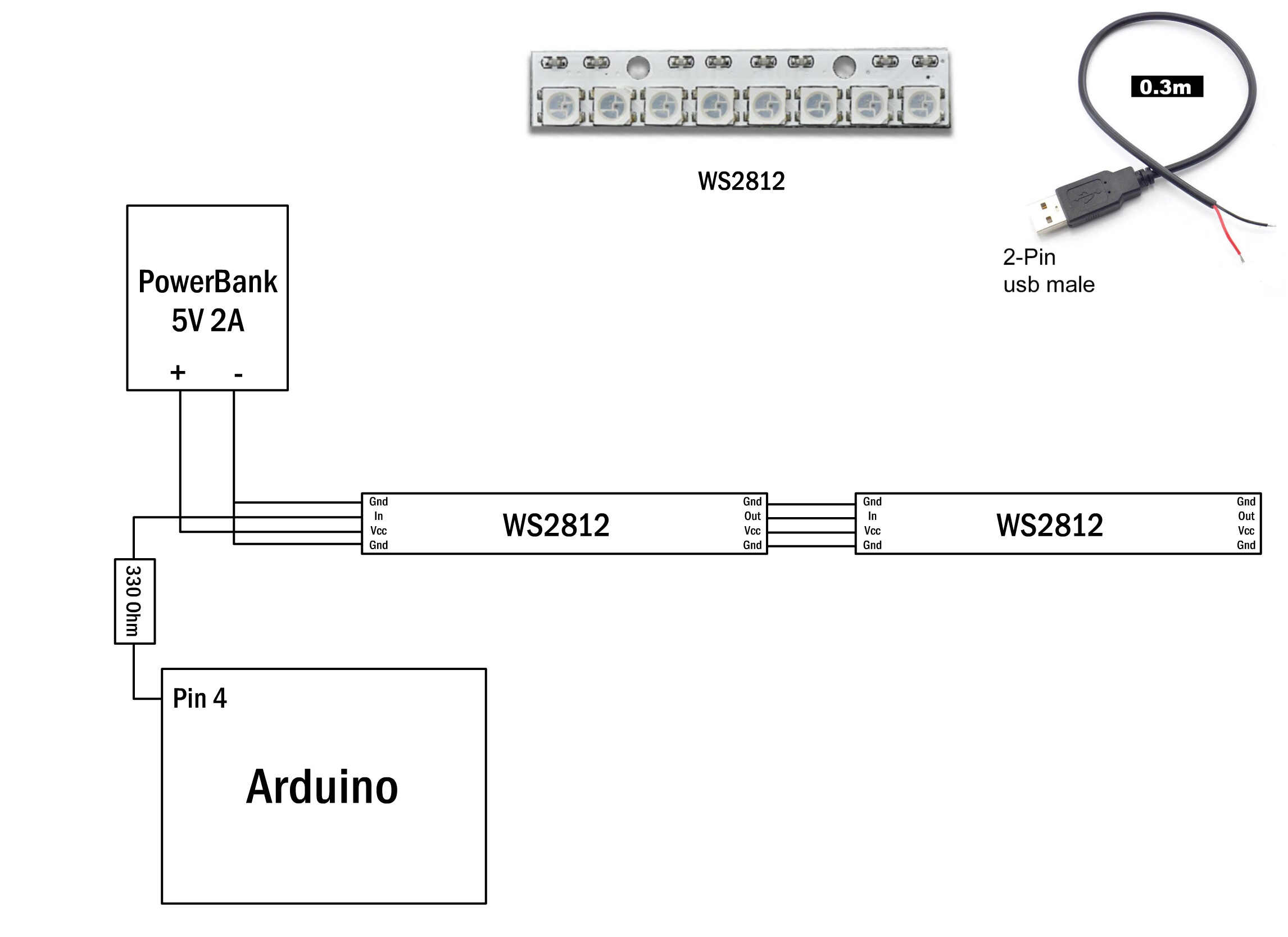

Hi, im planning to make a compact setup to power my led but I am unsure if my circuit will work without damaging the components.
I want to power my led stick which will consume 5V 480mA each and I'm using two of it.
For my setup I'll be using:
Power Bank (output 5V 2A) (powers the led)
usb to 2-pin adapter (to connect powerbank to the led)
Arduino board (unsure which version I want to get)
ws2812 led (the 8-led stick)
My Arduino will be powered via type c from a separate power source
This is a rough diagram of how my circuit might look like (i haven't purchased the parts yet so i can't show a real-life connection)
Any guidance would be appreciated!
  • Power supply negative goes to Arduino GND.

Thanks for the quick reply! So for modification i just have to connect another wire from the power bank negative to the gnd pin of my arduino and up the resistor value a little and i'm set?
That's right!
1. Data line resistor: I typically use a 470-ohm resistor in series with the LED strip data line. It protects that first pixel or so from damage in case there's a data spike.
2. Common Ground: Run a ground wire from the negative of your exterior power supply to an Arduino GND pin. I usually just cut a male jumper wire in half, strip the cut end and solder that to the power supply negative wire. Then, use the remaining end with the male jumper to plug into an Arduino GND pin.
3. Electrolytic Capacitor across the power supply (bonus): I don't know how big your LED project is, but for longer runs I add a large electrolytic capacitor across the + and - of the power supply. This protects your LED strip against damage from any voltage spikes.
Best of luck with your project!

You will need to add a large capacitor from the power to ground on the input to the strips. If they are long strips, then adding another at the end is a good idea as well. With very long strips you might have to have another one at the mid point.
Please read the link in post#3.
The other problem you will have is with the sequence of powering up and down using the two power supplies. Best to use a double throw switch to power both at at the same time.

As for the electrolytic capacitor, it would be more accurate to say that it filters out voltage fluctuations to provide a smoother and more stable DC power supply rather to say that it outright prevents voltage spikes.
Here's another resource for using capacitors with power supplies: https://eepower.com/capacitor-guide/applications/coupling-and-decoupling/
For convenience, here's the part about how it works with regard to power supplies:
A decoupling capacitor acts as a local electrical energy reservoir. Capacitors, like batteries, need time to charge and discharge. When used as decoupling capacitors, they oppose quick changes of voltage. If the input voltage suddenly drops, the capacitor provides the energy to keep the voltage stable. Similarly, if there is a voltage spike, the capacitor absorbs the excess energy.

Yeah but it is there for another reason, to protect the Arduino against accidental shorts ? (or even bounce) It is a current limiting resistor. To prevent adding capacitance a metal-film is preferred over carbon film.
