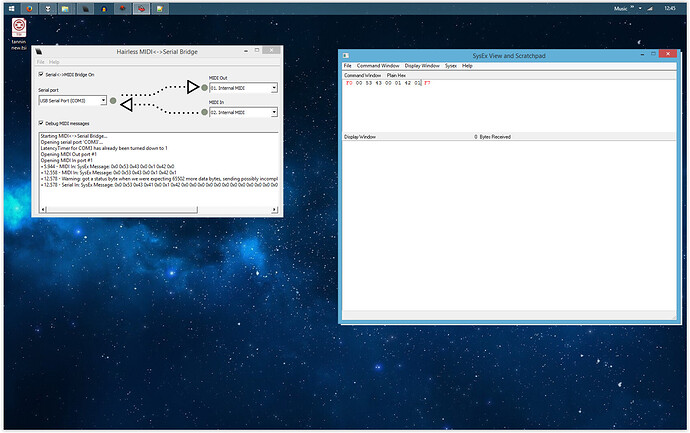

Here's some screenshots then. So, my project is a MIDI controller capable of understanding SysEx messages. Depending on received messages, Arduino either changes some data inside EEPROM (SET command), or it reads data from 328p and sends it back to MIDI app (GET command). In this scenario, I want to find out MIDI notes for each of 64 buttons. Response is SysEx start (1 byte), 3 ID bytes, 4 other bytes used to determine message type and 1 byte for each button. So that's 73 bytes in total. First attachment shows what I get when serial buffer is set to 32 bytes. Response is 33 bytes long instead of 73. Second attachment shows exactly the same message being sent to Arduino, only with 255 bytes of serial buffer. No other code changes. Works just fine, without any warning.
