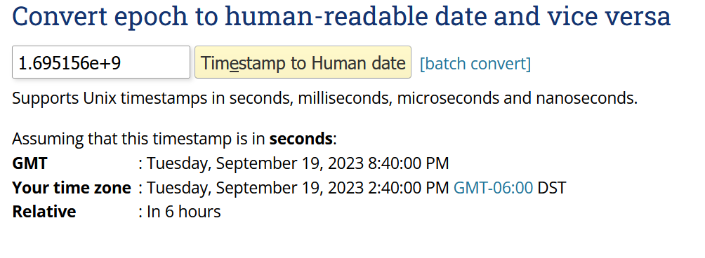

I have been trying to understand why the scheduler would not work and found that the scheduler time is not using the correct time zone I have set at thing level even though ArduinoCloud.getLocalTime() reports my local time and scheduler widget shows correct timezone.
In the image below I was able to set the cloud to 1500 (+6 ahead of real local time) even though local time was 900 and it worked as expected. I am at -6 (ignore timezone reported in image as i was testing) and when i checked the utc conversion, it shows GMT as my actual local time as seen in the second image.
Any idea what is going on?
