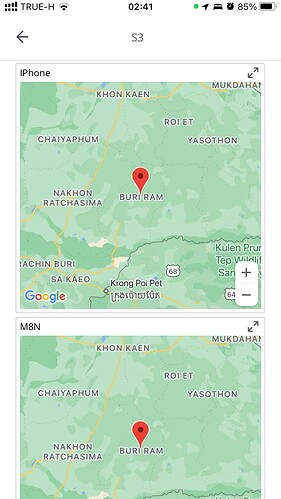

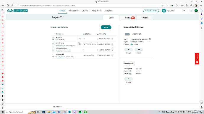

Cloud Variables have not been updating by Thing to Thing communication
  • I have been leaving it update for couple week, but nothing happened.
  • I need to send data from my IPhone's Sensor (Location, Compass.) to ESP32-S3_DevKitC-1 for calculation code.
  • Lately, I just tested by ESP32 read Variables from ESP32-S3_DevKitC-1 but nothing happened.
  • The widgets in dashboard are properly work. It can read data from both of Board and IPhone.

Hi.
is this line compiling properly?
  while (ss.available() > 0)
    if (gps.encode(ss.read()))
      displayInfo();
I would propose
  while (ss.available() > 0) {
    if (gps.encode(ss.read()) {
      displayInfo(); }
but first, you should test your board and data exchange with Iot cloud in a simpler way, like sharing few values not coming from another peripheral but simply light a led on your board.
EDIT: sorry, I just read (again) and see you have proper data exchange with IOT cloud.
