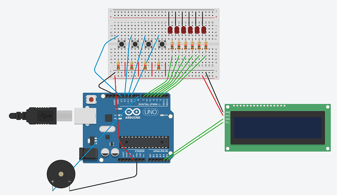

Hi all,
I'm running into a problem and I really can't find where it goes wrong.
Trying to make an fuel injector tester and it is actually working ..almost.
first of all I have this code

And this is my test enviroment
The code works (opens and close the injectors (leds for now) as long as I keep the RPM under 800 -> int pags[5] = { 0, 6, 800, 5, 10 };
The serial log shows me (when under 800 RPM) perfect open and close times, but when I change to 800 of higher, the first 2 leds/log-lines don't close the current led/injector.
In the next loop it al goes well.
When I really strip the code so there is only a start button and I hardcode the RPM to any number, everything goes well...
Im really searching DAYS now, but really can't find the problem...
The log file now looks like this when 800 or more RPM
2  open: 3435	close: 3438.80 (start by btn)
