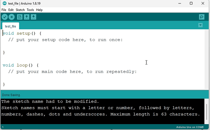

I did tests using IDE versions 1.8.19 and 2.3.4.
  • In Arduino IDE 1.8.19, I opened a new file.
  • I tried to save it as 'test file'.
  • The IDE saved the file as 'test_file' and outputs a message saying the name had been modified, and explains why.

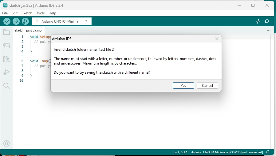

  • In Arduino IDE 2.3.4, I opened a new file.
  • I tried to save it as 'test file 2'.
  • The IDE opens up a pop-up that says the name is invalid and asks you if you want to save it with a different name.
I was aware of how IDE 1.8.19 handled the situation, but I did not know what IDE 2.3.4 did, as I had already learned to not put spaces in the file name by the time it came out.

In my opinion, the behavior of Arduino IDE 2.x is an improvement since it gives the user the freedom to chose their own compliant sketch name instead of just going ahead with giving it a different name from the one the user intended. For example, the user might want to follow the common convention of using the "PascalCase" style for the sketch name instead of the "snake_case" style forced by Arduino IDE 1.x under these conditions.
