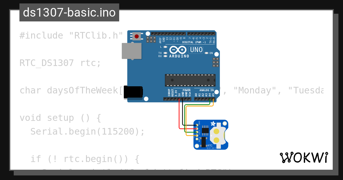

RTCs are very easy to use, I suggest you find an unrelated project or example and develop the ability to set and read an RTC.
Here's one and it will also introduce you to the wokwi simulator. The RTC used is an older model, but the code should work with the DS3231 work at the basic level of HH:MM:SS.

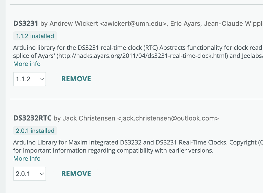

A good learning source for things like an RTC is to load up a library and look at the examples that come with it. Here are two good libraries with lot's of examples.

i think it is specific to the UNO R4 -- I installed the following library:
NTPClient library (GitHub - arduino-libraries/NTPClient: Connect to a NTP server)
Its documentation includes an example that shows how to set the RTC (Real Time Clock) on the Portenta C33 / UNO R4 WiFi to the current date and time retrieved from an NTP server on the Internet (pool.ntp.org)., and then the current time from the RTC is printed to the Serial port.
I used this example and was able to upload it to my board with no issues.

Yeth. I don't use a library, and the code I wrote works perfectly on both DS1307 and DS3231 RTCs. If all you want is HH:MM:SS, the code works. The DS3231, genuine units anyway, is very accurate.
The wokwi example, which I have just taken the trouble to test with an UNO and a DS3231 works perfectly, as I mentioned it might.
I added to the setup() a bit of code so you can at least edit in a time that is more like now. @aacuil will want to get the time from somewhere, that's another little detail to be handled when the mood is right.
