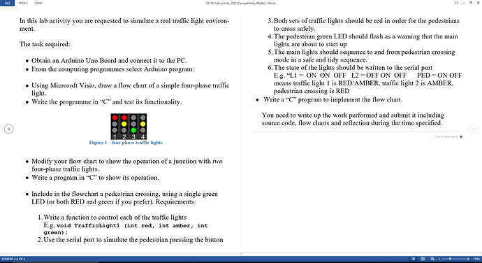

Hey guys, so i'm making a program for uni which simulates two 4-way traffic lights and a pedestrian light.
So I managed to finish the program using 'switch' statements inside functions. However I have been told by a lecturer that this is not acceptable. I can't have the Switch statements in it.

They want the code in functions like this...
void trafficLight1(int red, int amber, int green)
I've been messing around with this way and I am totally stoked at what I have to do, haha. He said it would be easy but I just keep getting this error...

p.p.s. Attached is a picture of the requirements, if you fancy checking out what I have to do to get a better understanding of my issue. Thanks

When I read your tasks in the picture you posted, I read that you have to do THREE flowcharts and THREE C-programs.
1.) Single 4-phase traffic light
2.) Two 4-phase traffic lights at a crossroad junction
3.) Same like 2., but with an additional pedestrian light and a button for pedestrian green request
You have 1.) and 2.) already done?
