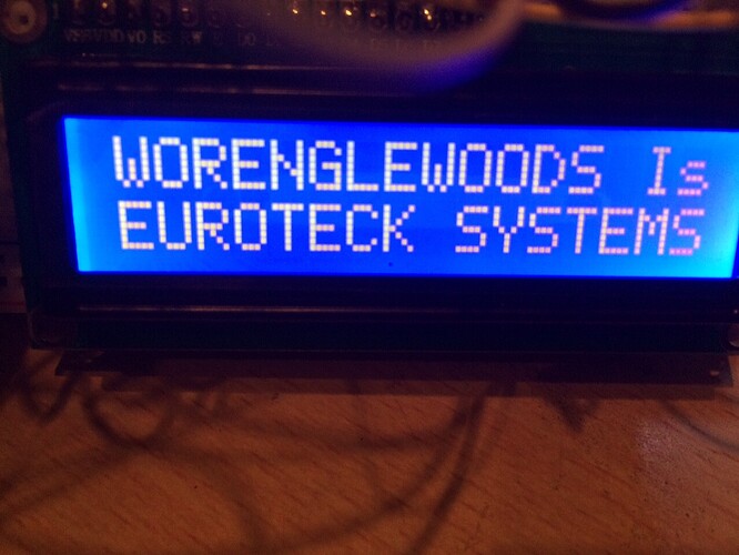

It doesnt go back to the start, its says ENGLEWOOD EUROTECK SYSTEMS - TEMPERATURE SENSOR - WORKSHOP TEMP - C - F .
It just stays on with WORKSHOP TEMP and flashes betweewn C + F.
I want it to go back round to the start after the F
move this part of the code from setup into the start of the loop.
do not move Serial.begin or lcd.begin
 lcd.setCursor(3, 0);                                            // Set LCD cursor position (column, row)
 lcd.print("ENGLEWOODS");                                      // Print text to LCD
 lcd.setCursor(0, 1);                                            // Set LCD cursor position (column,row)
 lcd.print("EUROTECK SYSTEMS");                                       // Print text to LCD
 delay(5000); // wait 500ms                                      // Delay to read text
 lcd.clear(); // clear LCD display                               // Clear the display
 lcd.setCursor(2, 0);                                            // Set LCD cursor position (column, row)
 lcd.print("TEMPERATURE");                                     // Print text to LCD
 lcd.setCursor(4, 1);                                            // Set LCD cursor position (column, row)
 lcd.print(" SENSOR ");                                   // Print text to LCD
 delay(5000);                                                    // Delay to read text
 lcd.clear();                                                    // Clear LCD
Okay ive done that.
The start text over laps the end text when looping (Just at the start)
lcd.clear();
it wipes the display clean before the next set of text is written
Still the same :-S
