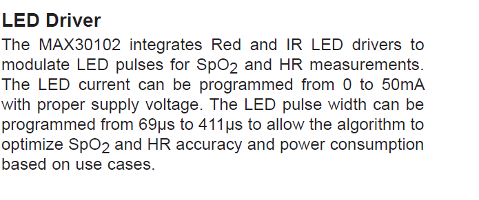

What you want to do is amplify the signal from the pickup BEFORE any AtoD conversion is done.
This would give you the best levels to detect while minimising noise.
This may be of help, you will have to look up how to adjust the IR LED drive which may increase the systems sensitivity.
If you use digital logic to multiply the level you get from the sensor at the moment, you will be increasing noise, and decreasing resolution of the signal.
